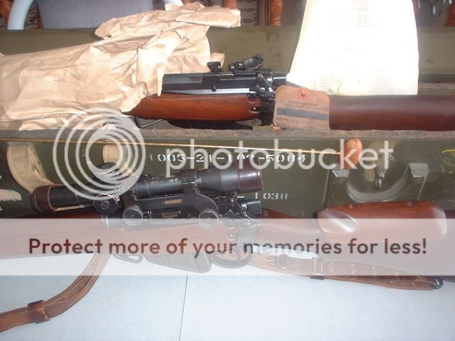

6. Get all the accessories for it, hopefully with the rifle. The little steel box for the scope is getting to be around the $400 mark these days, as is the transit chest, and the origional scope bracket. The leather sling, in good shape, runs $100-150. And the scope itself will set you back more than $1000.
7. And as Badger Dog said, show us all pics. The Enfield addicts always love to see another example.
