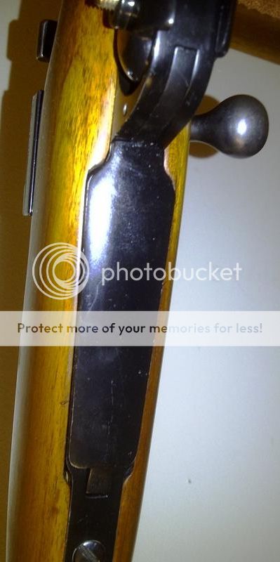

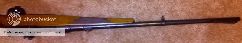

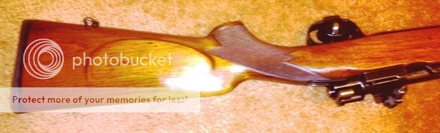

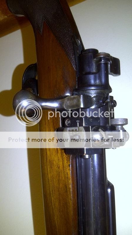

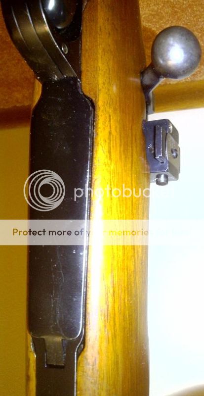

I have posted some pictures. I have tried the metal with double trigger (Zastava) from Tradeex and it fits the same as what is in there now ( a bit snug width wise through the mag well area tho).
hmmm, now that I look at the pictures, perhaps I can use a TIG to build up that front should portion of the Zastava metal to have it fill the wood space.

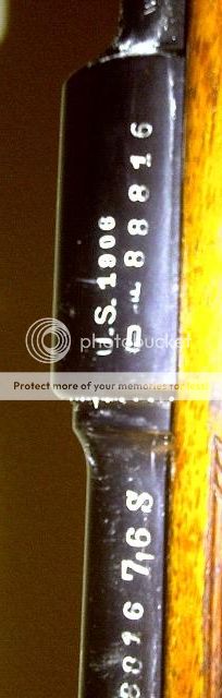

And I need to pull off the stock to check the bottom date stamps as well.
The double triggers and guards from Trade Ex are from La Coruna arsenal, Spain, not Zastava. Zastava have a round release bottom, which you push aside to open while the Spanish ones are same as Parher-Hale, at the bottom of the the trigger guard. If you are skilled in welding, you will be able to build up and then file the missing spots to fit.
Nice old rifle, the serial on the receiver dates it at about mid 1924 - 1925. To get an exact fir may be a reach
however replacing it with a steel unit even military / not, tig modified / not would be step in the right direction.
