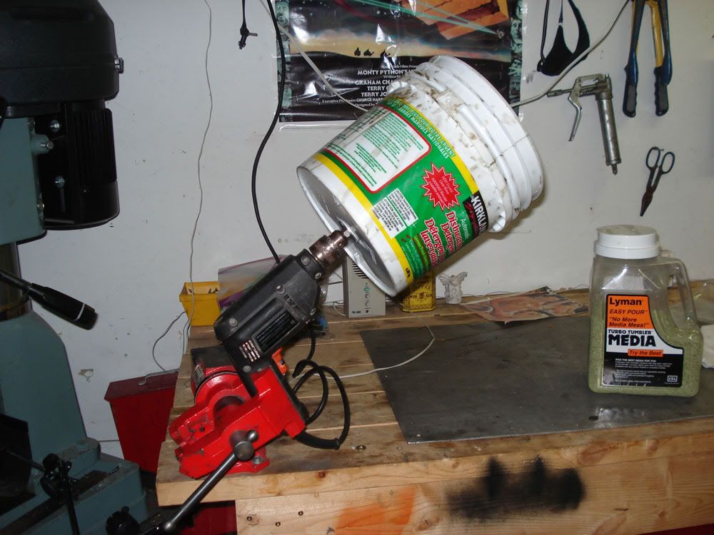

This was my first attempt:
FAIL! The rheostat was not thrilled about providing enough power to keep it spinning and then not spinning so fast as to let centrifugal force take over (Thus ending the tumbling).

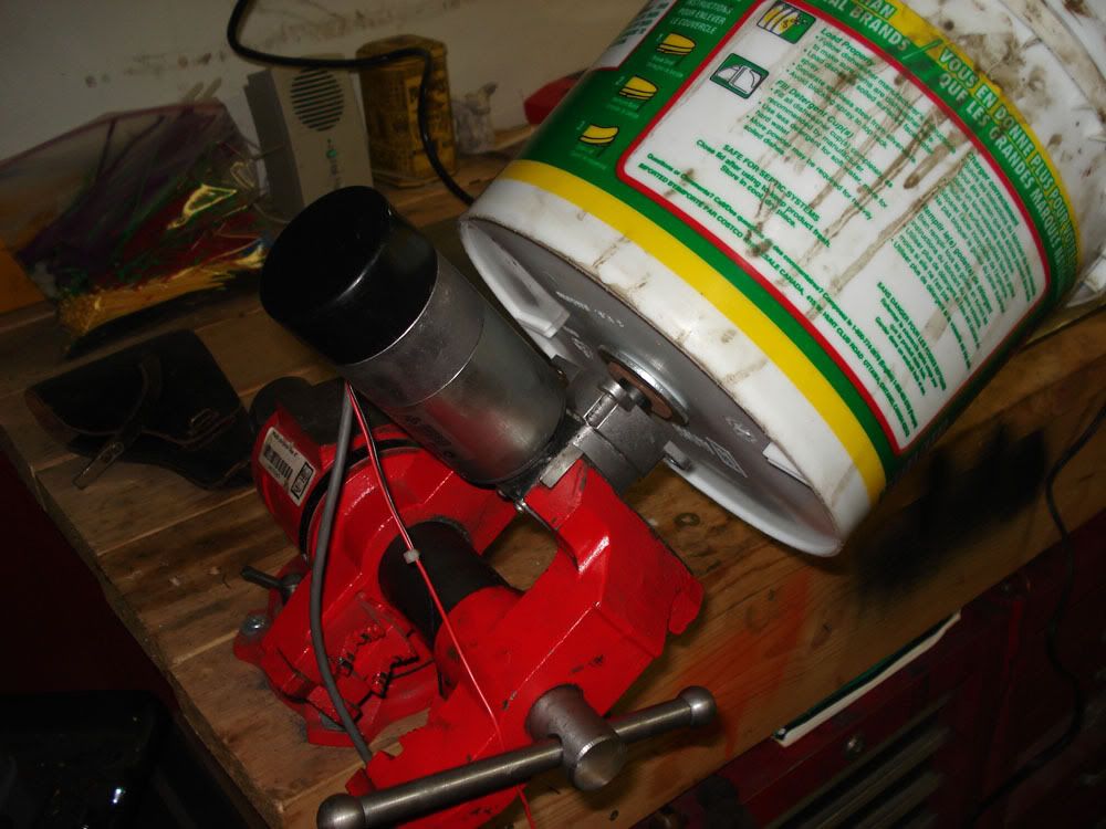

WIN! I found this wiper motor in my junk bucket and I have NO IDEA where it came from! But I'm happy I kept it
It was spinning too fast on 12V so I dropped it down to 6V and it was PERFECT!!!!
So if you have an old wiper motor, an old bucket and a 6V power supply kicking around (which I did lol) you have your self a super cheap brass tumbler
