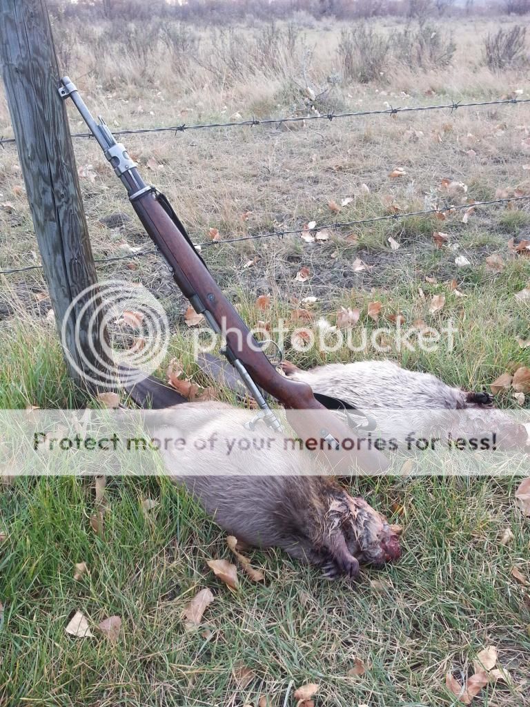

Since I got my license in August, already at my fourth and last for a while (I keep telling myself lol).. Could not for the life of me stay away from the mosin after loving my sks. The back end of the stock could use some work, but I kind of like the ruggedness in it. Smooth bolt and matching serial #s on almost all of it.
