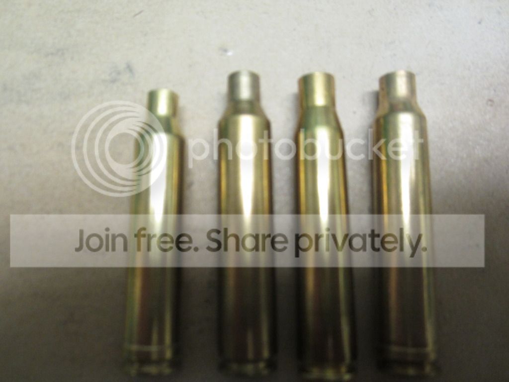

I built one years ago and have the reamer, if you want to go 30 degree shoulder and an improved case. I equals the 7mm-300 Win Mag, as case capacity is identical to a W-W 300 Win Mag case. It does in fact equal the 7 STW and is a very nice looking and well balanced cartridge, more so than the STW and runs through a 300 WM length action.

For data I started with top 7 RM data and worked up from there, using IMR 7828, today RL 22 and possibly 25 and H1000 would also be good candidates. I got 3400 fps with 160 gn bullets and hunted in Texas with it a bit, no wait that was a 7mm-300 WM, but identical ballistics.
Here's a photo...........Sorry, not a very clear phot but from left to right is 7mm Rem Mag, 7X68 imp, 8X68 factory and 300 Win Mag
