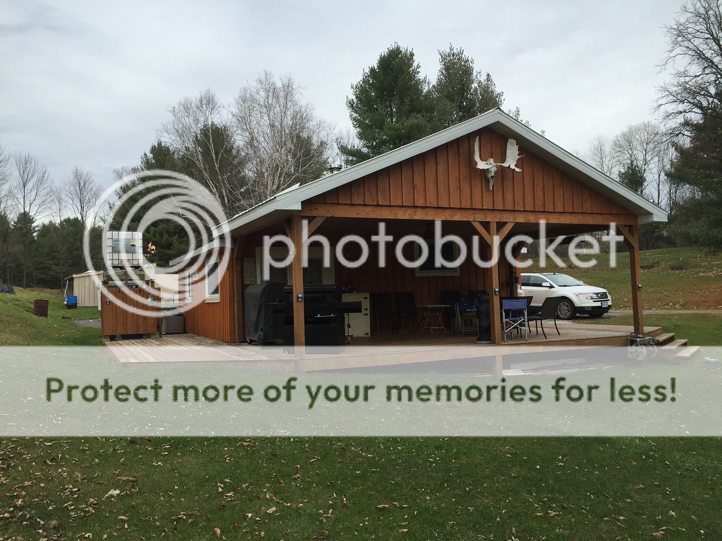

Here is a pick of my camp.... Where I have the pleasure of using an outhouse.... :) .... I do have running water that works when the generator is running, but when the camp was built it wasn't done with the use of power in mind and no bathroom was installed.
On the left is a food grade water container I built a frame for to keep it off of the ground. I simply fill it with the hose when it starts to get empty. I have a hot water on demand setup hooked to the bottom of it for the outdoor shower, and in your case OP, you could do likewise and run a line in to the cabin for your toilet.
