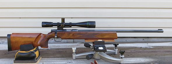

This has been working well enough for me
