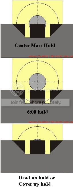

I just bought a Girsan Regard (Beretta 92 clone) and also had trouble shooting it. Read up on it later and apparently the Beretta 92's are set up for a combat sight, not 6 o'clock like I'm used to, which would explain why I couldn't hit the target until I felt like I was aiming high (well, that and the fact that I'm bad)
If they give you a dot, odds are they want you to "drive the dot". Centre the dot, also the single action pull does require a shift in finger position on the trigger from the double action pull.

Equal light and equal height still applies. The difference is instead of putting your intended POI on top of the front sight blade, you put your POA under the dot, which would bring your shot up.
Edit:^^^ Dietz has it.
The sights won't be the problem. Use 124 gr bullets and use Center Mass Hold as illustrated above. That is the hold I use with my Berettas and a Girsan. If the bullet goes anywhere but in the center of the bull the fault lies with me or the bullet just decided to go where it wanted to...come on it could happen. The fault usually (always) lies with me. LOL When I am off it almost always me dipping.
