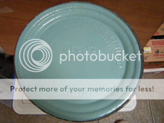

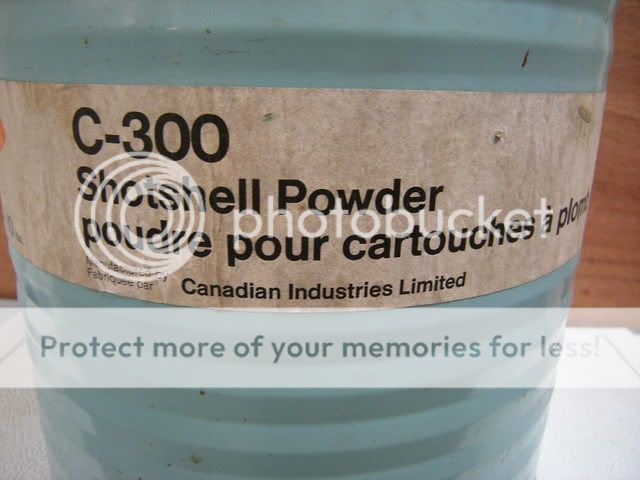

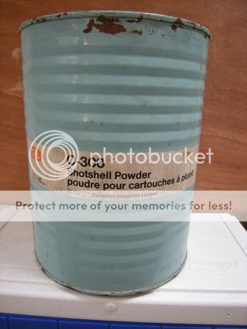

I don't think this C-300 powder or cannister is all that old. Maybe 1970's? Took a couple of pics:
Bottom of can:

Also the can is certainly no older than the 1970's as bilingual lables were not required in Canada prior to 1970. (Official languages act - 1969)

Looking at the pictures of the can I would guess late 1930s. It is actually a pretty well made can, something that became scarce not many years later. I doubt if the loading charts were printed on the cans after WW2.

NAA, in the third photo there is reloading data ,it says using CIL components for a 3 drams equivalent load use 19.0 grains and for a 2 3/4 drams equivalent load use 17.5 grains. Now you need to find some CIL components to use or compare, so you can substitute or find an equivalent component. But it doesn't tell you the shot weights. Could that information be under the masking taped on piece of paper.
