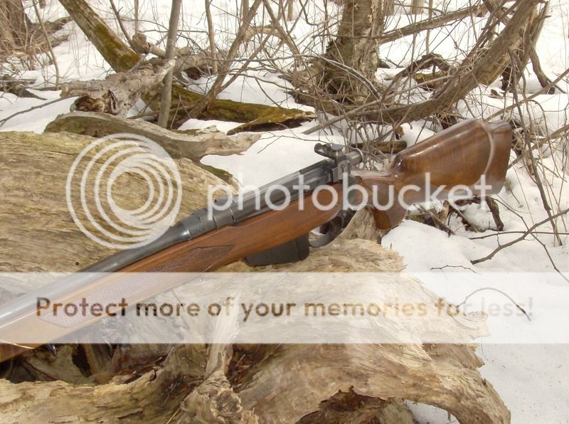

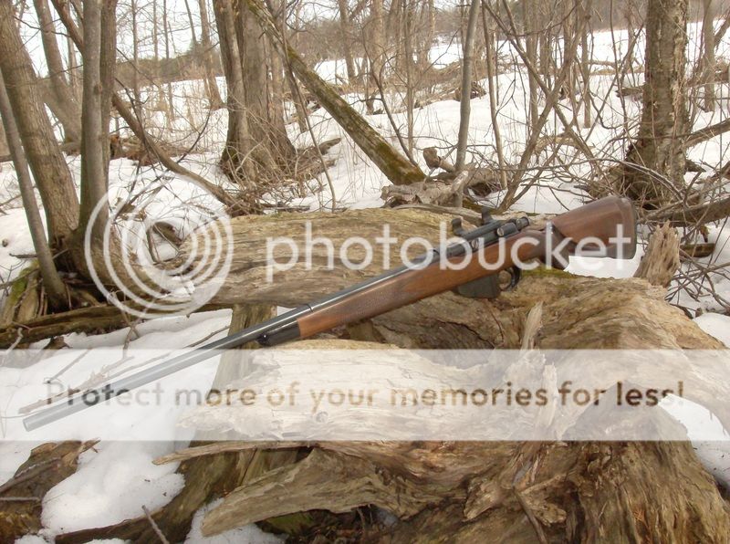

Well here they are. The one-piece stock .303 with its scope mount, no scope yet though - I have a Weaver J4 coming soon for it. I ended up inletting a piece of steel at the back of the receiver, hope this will help with recoil management. Still have to put sling swivels on it.

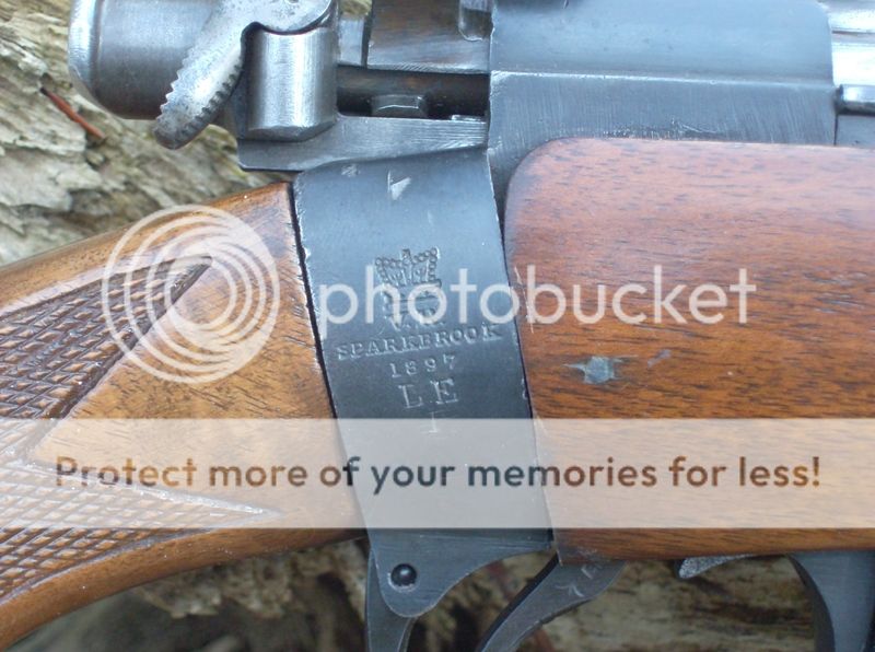

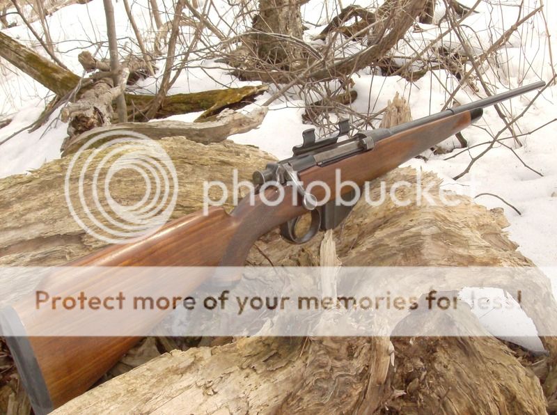

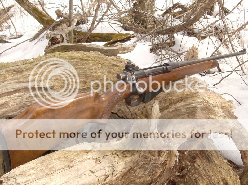

And another old one! Sparkbrook receiver, came to me with a so-so sporter stock, shortened barrel, slighly buggered up Lyman peep sight base... Jason Spencer did help me a lot here, finding another base for the peep and machined it so it followed the receiver contour properly. I had saved a decent sporter stock set a while ago, shows that sooner or later anything finds its use.
Can't wait to try these out at the range... Hope to find flush-mount mags at some point, I think it would look cleaner on both rifles.
First the one-piece stock:
Now the Sparkbrook:
