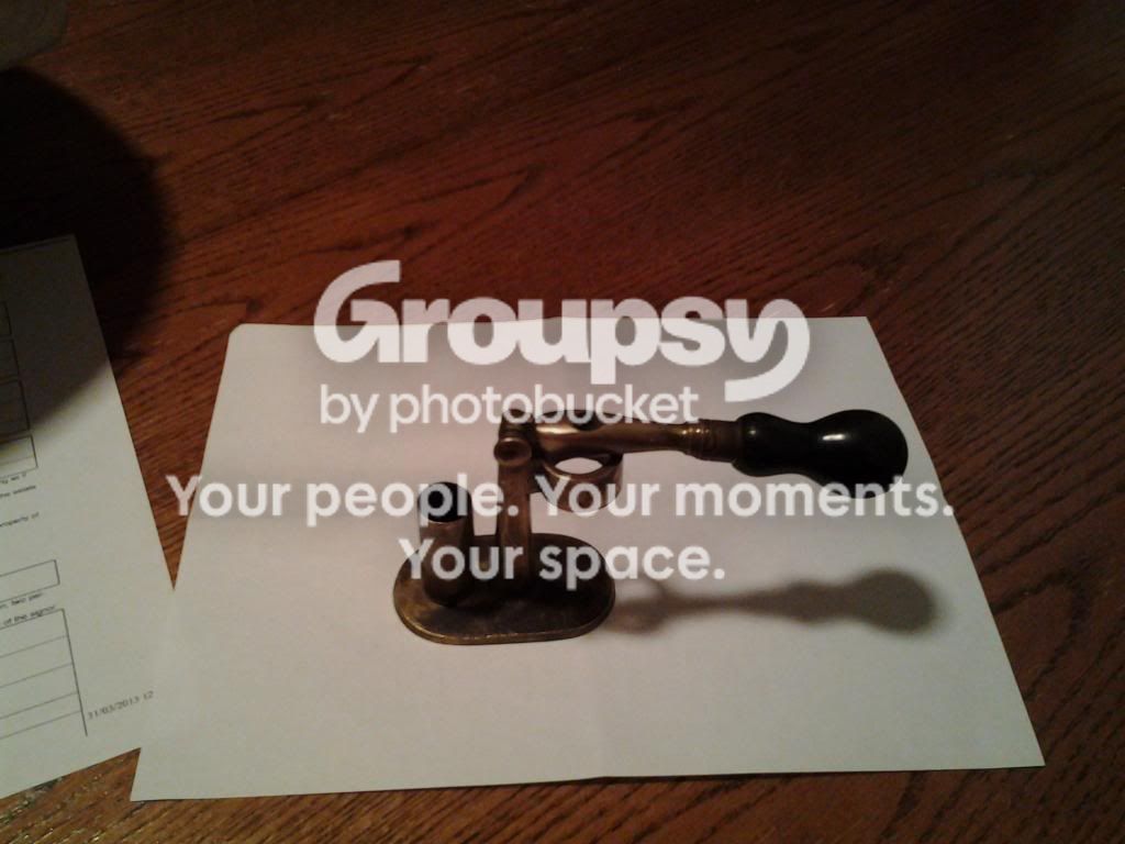

Found this handy little device at a gunshow but it missing a piece or 2 and I'm hoping someone can tell me what it should look like.

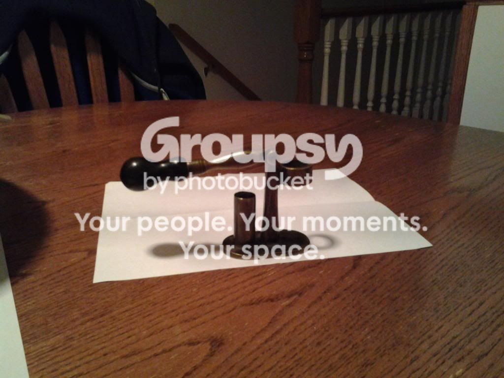

The tube that comes up from the base has some solder residue around the inside lip and should have held a de-priming pin of some sort. I'm fairly sure it was only meant to de-prime and re-prime cases but I'm hoping that there is more to learn about it. Anyone seen or used one like this?
More substantial than the nutcracker type priming tool I was using until it broke and the replacement I found doesn't look any better than the last one. Done hundreds with a hammer before that but like to find more elegant solutions.
the side with the tube on it should have an insert with a pin sticking up. The handle pushes down on the shell to deprime. The opposite side pushes the primer in. The ones that I have and have seen all had a simple post with depriming pin where yours has a tube

Figured it was just a depriming pin that is missing but wasn't sure if there was anything else to it. I'll probably cut down and find a way to stand a lee decapper rod in the tube.
Emptied some shells this morning so I have some to try it out on anyway.
