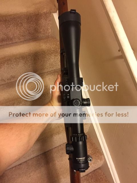

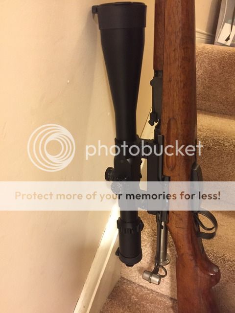

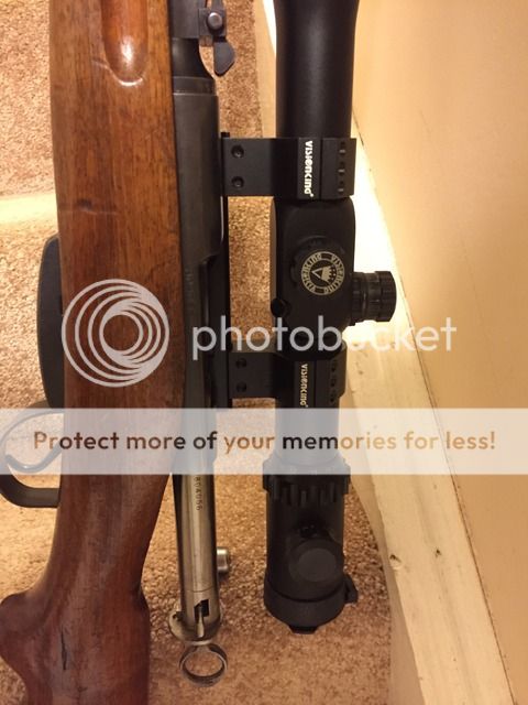

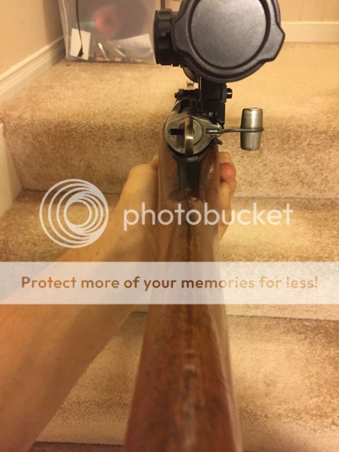

OK just seems odd
Garands & Russians have side mount on the left .
So does the Lee-Enfeld No4[T].
tac
OK just seems odd
Re the offset - not such a problem as you might think. As has been pointed out, there are good few military rifles with post-production offset scopes. Remember that these are NOT dedicated target arms, but made into sharpshooter or sniper rifles as a military exigency - some corners must be cut. The option - usually and unwelcome one - is to drill and tap. This is made difficult by the need to use carbide drills and taps as the KJ31 receiver is very seriously hard.
There IS a scope mount that goes over the bore, either from Germany or Switzerland, but it is ca. $400 or so by comparison with the $75-ish of the SP version. Add the fact that unless you are really gentle, you are also going to ding that brass.
If you find difficulty adapting your cheek-weld to the offset, remember my post above, and invest $60 or so in one of Peter Ogden's fine cheek risers. For those of you who already shoot a No4[T] shooting offset is nothing new.
