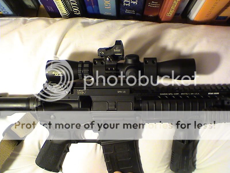

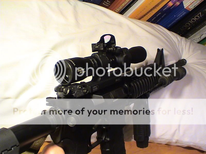

To get the eye relief I wanted on my "precision" AR I used a Larue mount. It pushed the scope far enough forward to solve the problem.

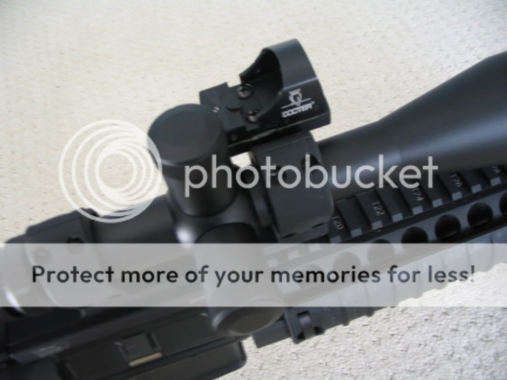

I noticed you put the red dot on the left side of the scope. I think I like that better,...most times if we shoot around barricades,...I would rather cant the rifle mag pointing in...but other mounts are on the right side of the rifle (ie JP/Burkett mount)..
Do you have to cant the rifle a little out to use the red dot, or can you see an unobstructed FOV.

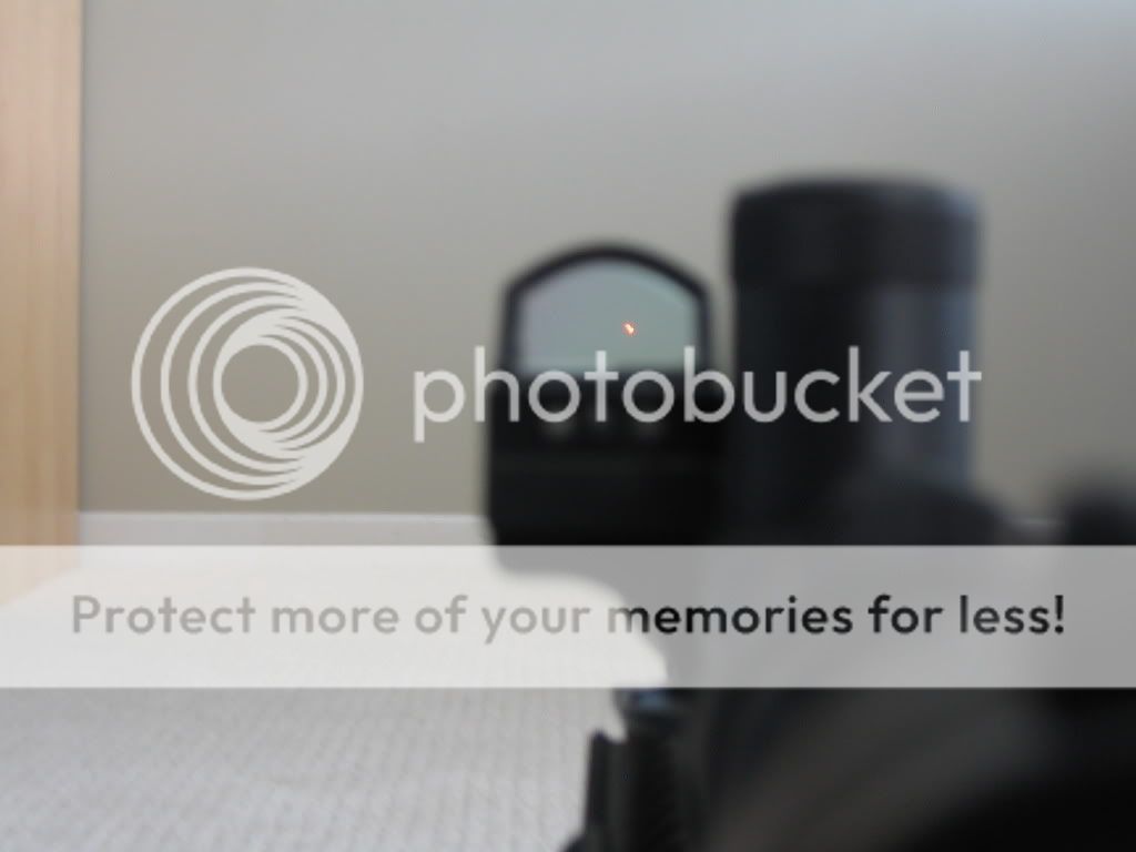

I wanted it on the left because I'm a right handed shooter, so for speed, if I need to go to the red-dot, then my head is already on that side of the gun.
When I use the Docter, I just break my cheek weld. It is a very fast transition, and great for fast hits on the closer targets (I've only used it to 100m).

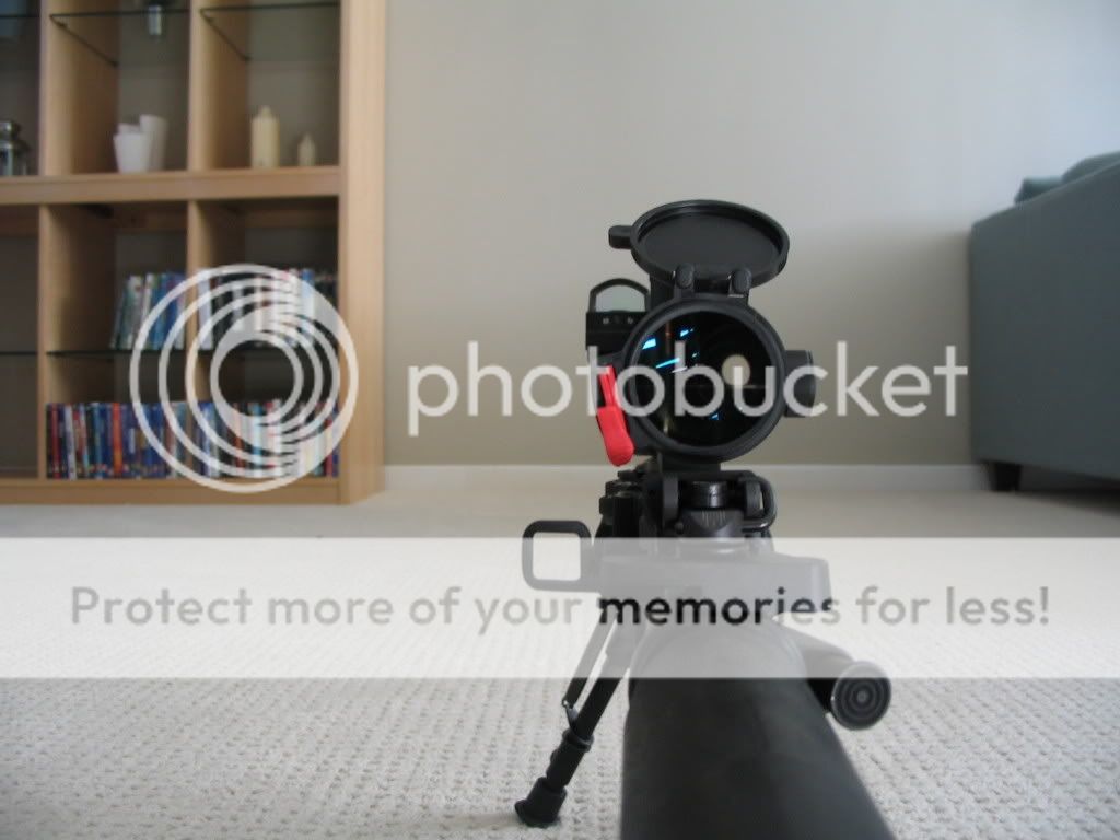

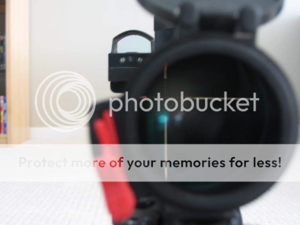

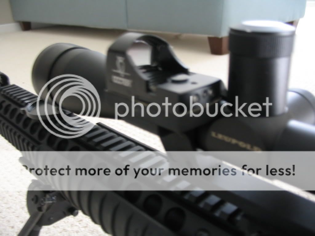

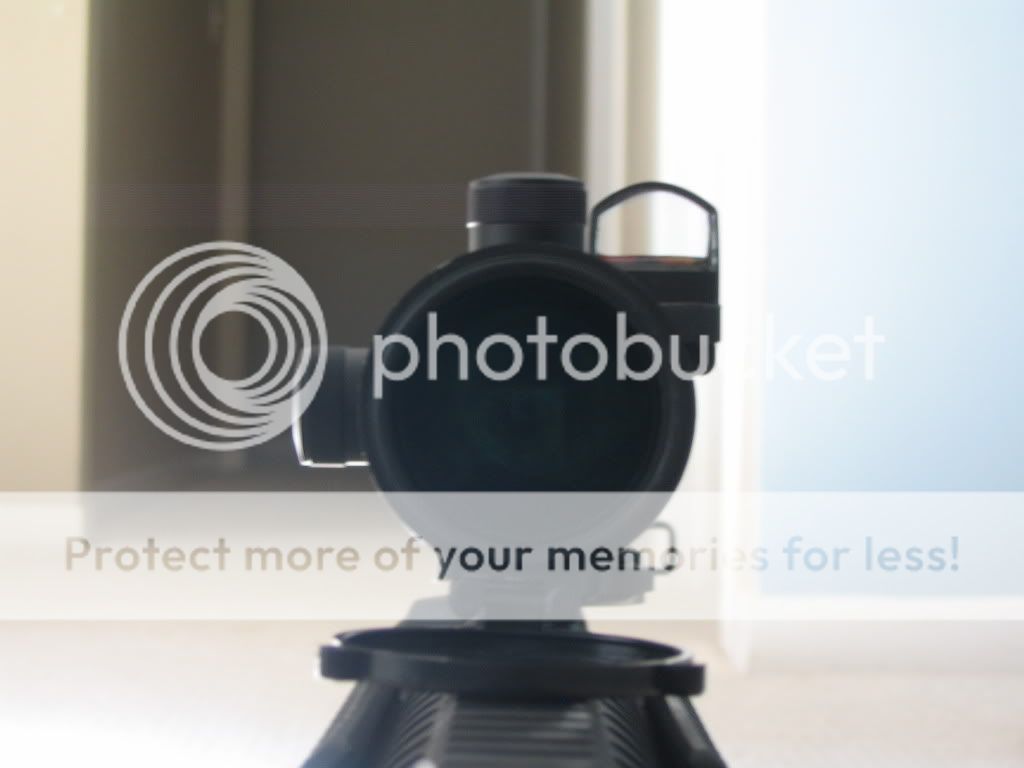

Here are a few pics closer up that show the sight's proximity to each other that might help as well:
(excuse the blurriness, it just did not want to focus at this distance:redface:)
From the front:
