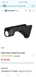

I love my Olight. Pic rail mounted.

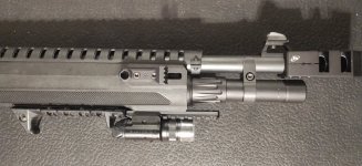

Picatinny rail with the mounting holes spaced accordingly to mount on the mlok slots that are on the Mod2 handguard. I used a MDT rail that I modified.
