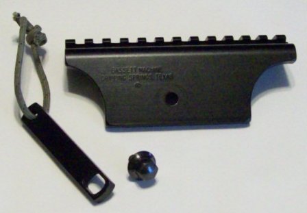

Ordered the new Bassett Scope Mount

Well I ordered the new Bassett scope mount even though I do not plan to scope my M1A anytime soon. :dancingbanana:
Pictures of Bill's new mount for 150$ just released today!
7/16" clearance for the iron sights!
· Weaver T-10 Scope with 1" diameter tube
· 50mm outside diameter Objective Bell
· Old-style Weaver Low rings w/large knobs
· Rear iron-sight is all the way down
In case anyone is wondering they ended up selling 17 mounts in the first day of sales. :)

Is that the only attachment point? That single screw on the side?
If it is, that won't hold zero for ####.....
If it is, that won't hold zero for s**t.....
Not according to EVERY review of their original non-railed version I have read. Has to do with him using pins for location not a spline makes it solid and will always repeat to zero when removing it. ;)

funny how the nam era ones were only single attachment points - same deal with the isreali nimrods
Thanks for that T-star, really if the mount was designed and built properly a single screw will keep it secured on the rifle.
Funny how a single #12 screw or 1/4" screw can deal with a heck of alot more pressure and forces acting on it then a rifle can produce even when dropped but its still not "good enough". :rolleyes:
A #12-32 UNEF still would need over 700 pounds of force to shear it if made of a low grade (30,000 PSI) steel to shear. :eek:
Dimitri
The Basset mount uses a hardened round rod to locate itself in the V shaped grooves in the side of the receiver. The round profile makes it self centering and the tightening system of using the rifles weight to set the consistent torque on wrench to the the fastener makes it easily repeatable out in the field.
I haven't used one, but I would consider this mount for a dual purpose rifle that I wanted to keep the iron sights and stripper clip guide usable. I'm using a Smith 3 point mount, and so far its been solid.
