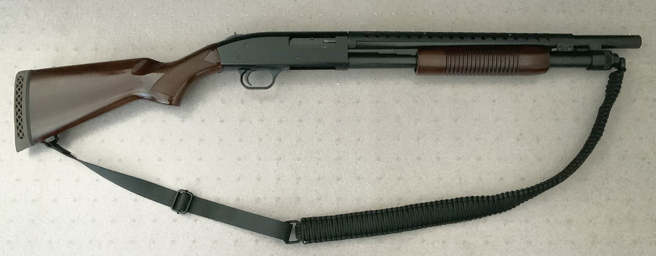

Ugh, the 835 came to me today and I swear the thing's never been fired. Unfortunately, the mag tube is too long for the 14" barrel. Who makes mag caps in house?
The barrel ring is about 2" below the magazine cap, but if a cap could be made that goes over the mag tube I could totally use the barrel. Think mag extension but reversed.
The 14” barrel uses a shorter mag tube. I would have the mag tube shortened by TacOrd if you’re having them do the work, or purchase the shorter mag tube.

Update: Bill, if it's not a terrible inconvenience I believe I will take you up on your offer and am in need to hire your lathe.
A quote from Casey at Tactical Ordnance "We do not do much work on 590s anymore. We can do the work as listed but we will not be moving barrel rings rechambering to 3.5” and we do not do Mossberg Accu choke tubes, only Remchoke, Wiinchoke and Truchoke.

Attached find pics of my vernier: Length= 1.390" (35.31 mm)/ Inner diameter= 0.920 (23.37 mm)/ Wall thickness= 0.150" ( 3.81 mm). The outer diameter is 1.279" (32.48 mm)View attachment 737384

Guys, I just wanted to give kudos where they're due. I bought a 14" Mossberg 590A1 heavy barrel and a Mossberg 835 to install it on...problem being, the mag tube is too long for a 14" mounting. Butcher Bill and his mill to the rescue!
This guy (Butcher Bill) reaches out to me, goes back and forth for over an hour with me regarding measurements (he's on the other side of the continent from me.), he sources materials by himself and on his own mill or lathe, and on his own time turns this out for me...and asks only that I cover the cost of shipping!?
It's a perfect fit! I have to either turn the front rack nut in a few turns, or on an emery cloth, take a few thou off the nut and reinstall. It's a literal c-hair from closing the chamber, but that's not the spacer issue, it's a barrel to receiver length issue and it's easily fixed.

Nice, glad to hear the spacer fits. Always interesting to machine something to fit an item you don’t have in your hands lol. Happy to lend a hand and help out a fellow gun nut, was enjoying a glass of the whiskey I picked up the other night and I hoped it would be a nice fit.
So the forend/action bar nut is too thick to let things lock up with the new barrel, should be an easy thing to fix I bet. When I bought a 14” heavy barrel for an 870 I had to lightly file a couple thou off the od of the chamber end of it to allow it to slip into the receiver, easy fix and I think the snug fit of it helps with slug accuracy.

So what’s the status on this project, did you get it to lock up?
Sure did. I had to take more off the nut than a few thou, it's actually only about a 1/16th proud of the wood, but she closes like a bank vault now.

The 835 with 14" 590A1 barrel was disappointing, but I'll fix it. I set up at 50 yards, and used a 6 o'clock poa hold on the bullseye with the front bead. Boom! Smoke clears...no hit. Tried again...still no print.
I try a combat type sight picture and hold over the bulls...boom! Still no print. WTF!? I couldn't even see where they were going...20 or 30 slugs and nothing on paper at 50 yards!? Then, in desperation I aimed at the ground in front of the target board...boom, bullseye!! WTF!? This thing shoots 3 feet high!? My mind turned to why, and how to fix it.
I forgot that the 835 has a large 10 bore barrel normally. The OD would be larger and it has a vent rib on top of that...the fix is a Mossberg Ghost ring and rifle sight set up. I have been put on a wait list from one of our dealers here. Although I have a significant astigmatism, I do have a spare Holosun red dot and S&J sell an adapter plate. I may very well go this route as I believe I'll have more adjustment out of the holosun, than the Ghost ring.
