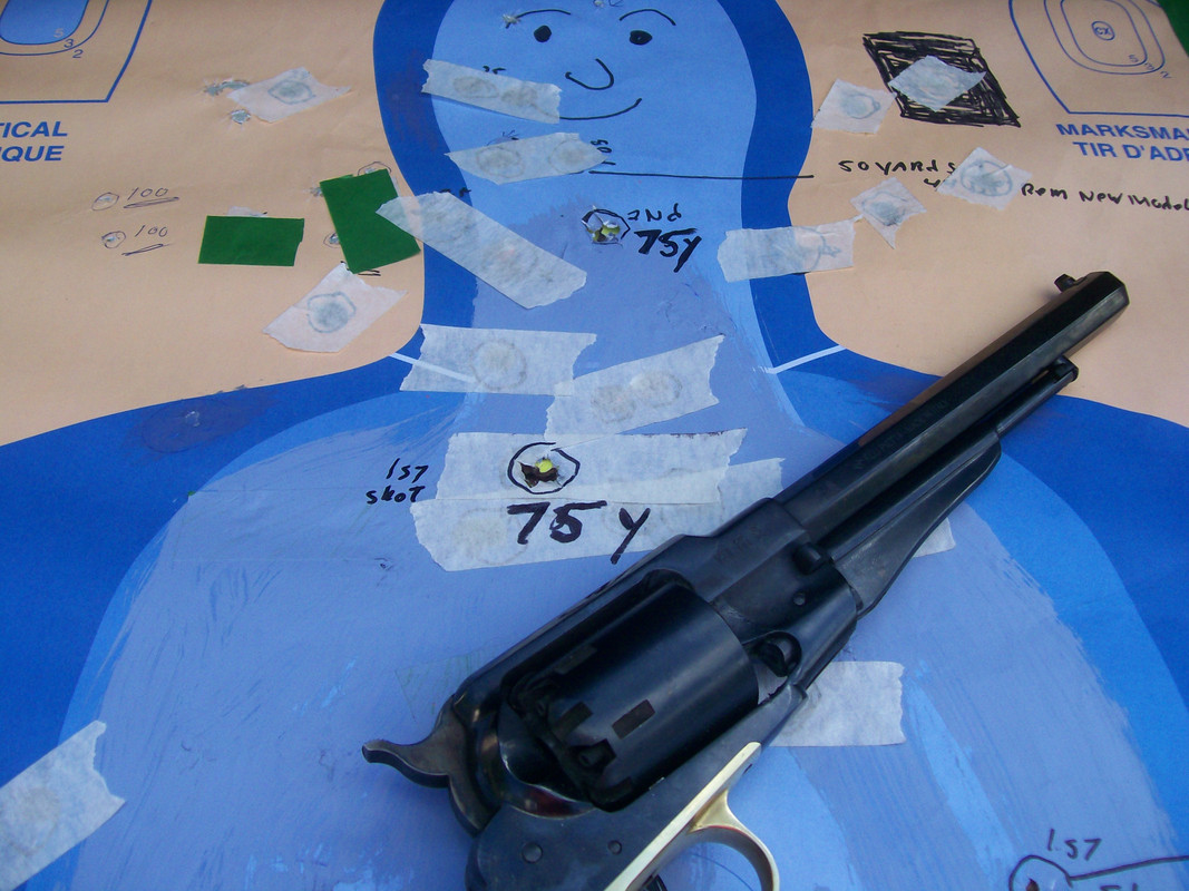

well....I 'm into Cap N Ball revolvers, and here is what I have personally learned.
what I have to say only pertains to revolvers,...No experience with BP rifles.
I was Re- creating the "Tut hickock " 75 yard shot where hickock places a Ball into Tuts heart on main street.
It took 3 days to figure out the powder charge " and dial in the sights".
My findings- when I used the WAD over the powder, I got erratic groups. some 18 inches off.
I found using NO Patch, then pressing the ball in,..then a smear of Vaseline gave me great accuracy at long distance.
Any patch, dry or oiled , really killed my accuracy.
using Pietta 1858 rem 44
didnt get the heart, but close ! middle chest & Neck
PS. If you really want Great Long distance Accuracy get your balls custom made. Hornady are good, but Not Great.
as well....True Black powder didn't make the cut, I used BP substitue.
Going for a 100yard shot next summer, but needed to upgrade to a gun with "Real Sights"
waiting for my new Target Model to arrive.

LOL...watched it several times , as well watched a few different ones as well.
Once you get your gun....your sights,.your ball and powder charge dialed in .....it is doable. Takes time and trial & error.
The 1st day I tried....I just about gave up.
I had to "Pean" the barrel, as it was hitting right to far.
another VERY IMPORTANT bit of info....The ball must be pushed in the same amount every time. Too much or too little will affect accuracy as well. " there's a secret to it"
If your only shooting 25 yards, you wont need all this extra tweaking and you'll be fine.
