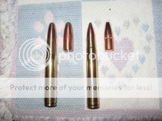

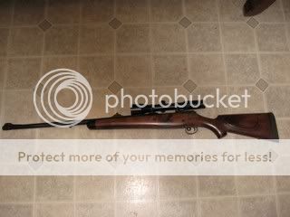

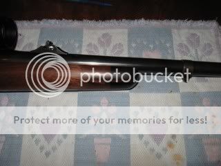

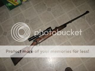

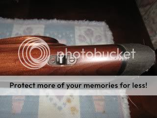

My kid brother turned a BSA P14 into a very nice 404 Jeffery...will post pics if I can figure it out....
Original purchase price of the P14 was $2.00 at an auction simply because the auctioneer couldn't get a bid on it....he said "first $2.00 takes it home!"
Best two bucks we ever spent..:D
I would love to see that 404J! email me the pics if you want, and I can post them here. (kell2784@gmail.com)
Need pics & more details. Who's barrel did he use? Where did he find brass, dies and what bullets is he using. Always liked the Jefferys cartridge but figured it to be a real pain finding components.
I'll forward pics to Kell later today for posting.
Barrel is a Bevan King rifled by him in Bevan's shop ( they are buddies ).
He and I both have found brass from various shops, gun shows etc., its both Bertram and A-Square.
He uses Woodleigh bullets in his and I prefer Hawk in 300,350, and 400.
I am going to get some of the new 450 Woodleigh bullets when available.
Initial load testing gave groups well under the inch with all 3 bullet weights and the rifle is a dream to shoot because its heavy.
Dies are CH made for the rifle when fired cases were sent to them.
As for finding components....no problem...I've also heard Hornady is going to make bullets soon if not already, and Barnes also lists 404 bullets.

Here are Kevan's pics of his very 404 Jeffrey.
