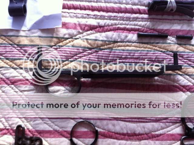

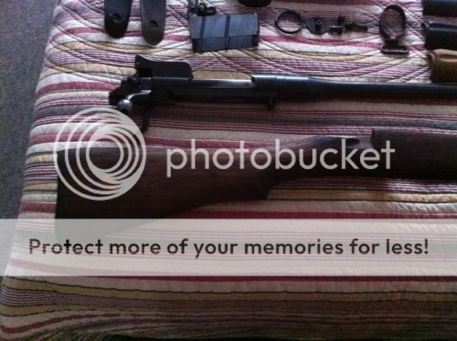

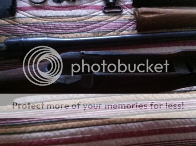

This is the stock set up in my (extra set of hands) tray.

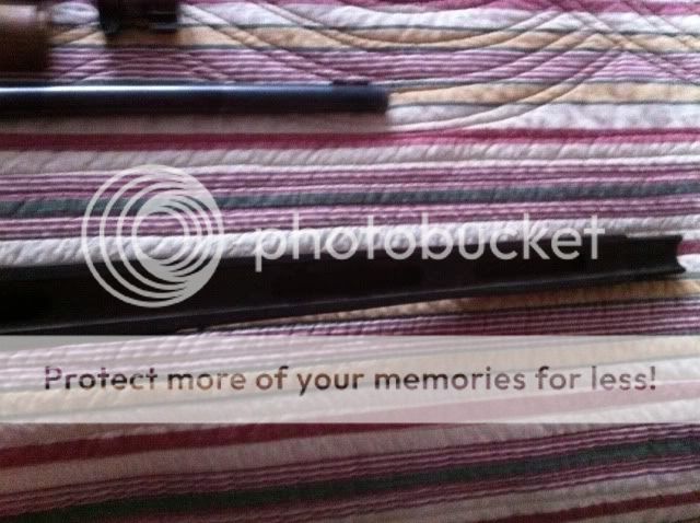

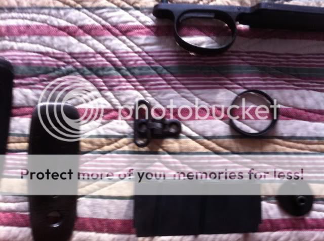

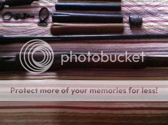

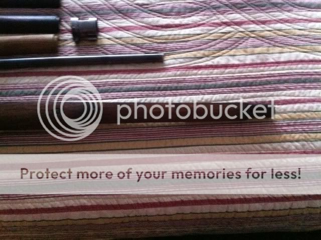

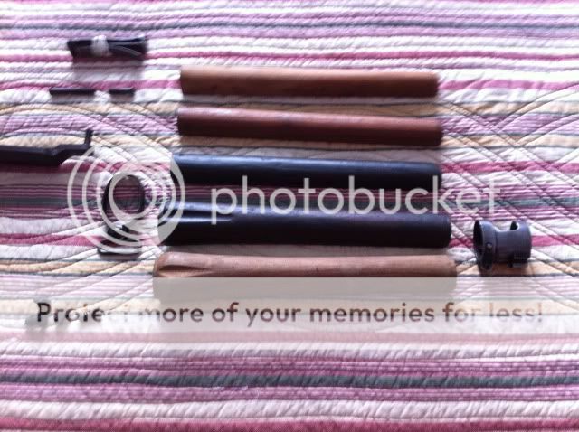

Here are several photos of the stock.
As can be seen in the third photo, there was an arsenal repair at one point; maybe at the same time the front volley sights were removed.

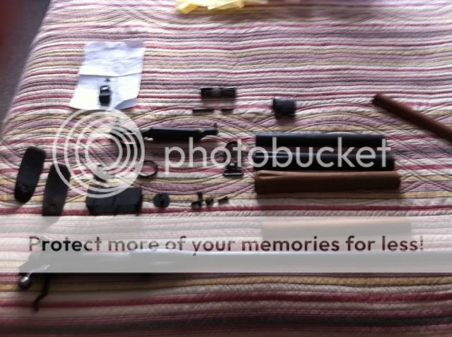

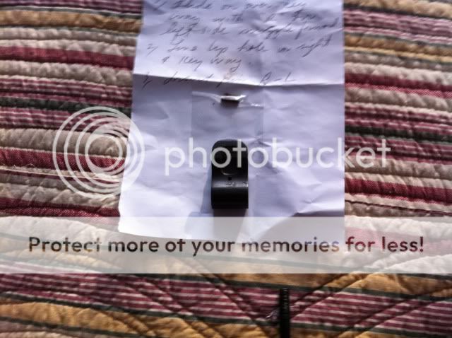

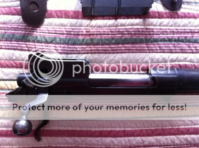

These are the parts layed out ready to be put together.

Next was the insertion of the action into the stock with the handguard retaining ring in place.
