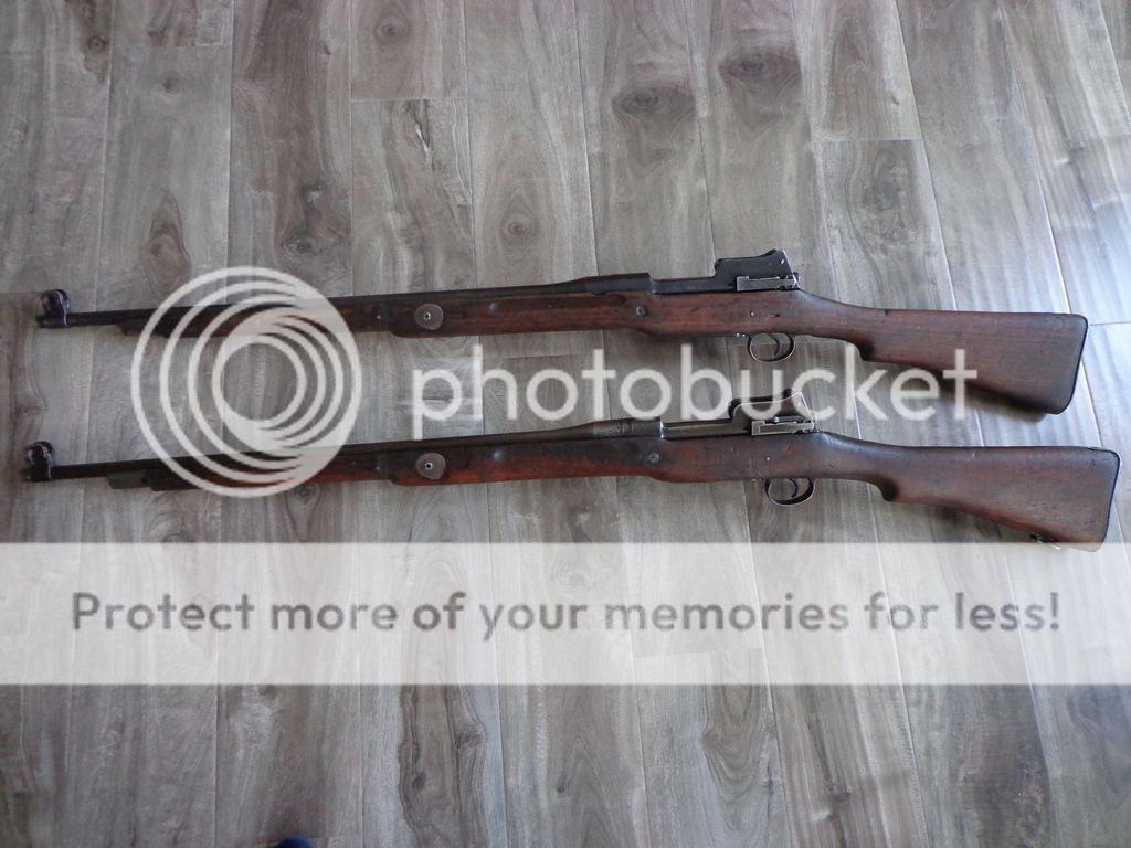

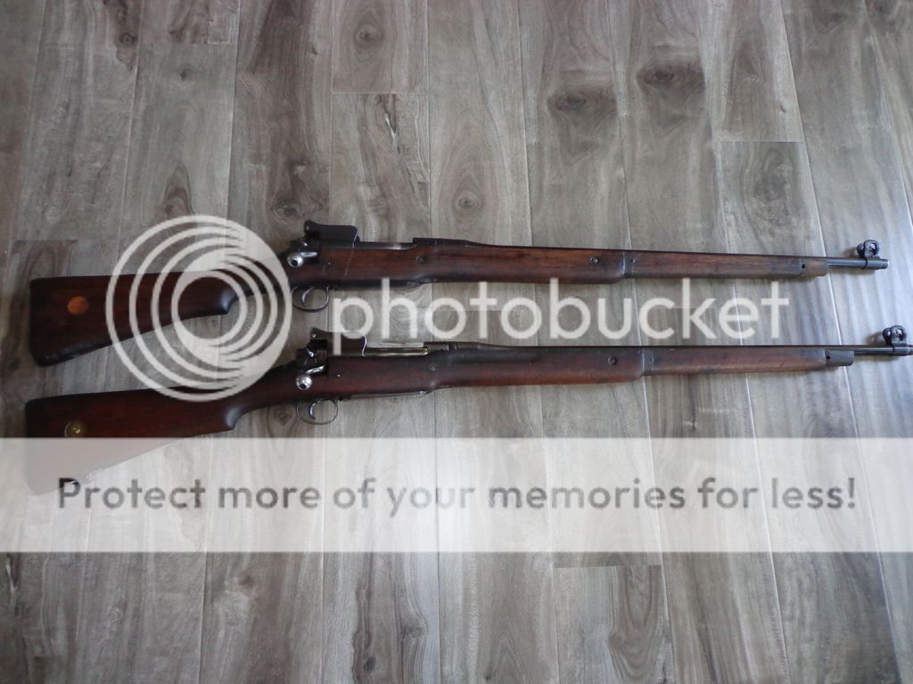

Received mine and have the actions installed to check for fit,the stocks are nice and straight ,they show their age but look the part as they are 100 plus year old rifles.these are two very nice actions that i have had for a long time they were both sporters and are now finally going back to as near original as possible.One is a rem the other a winchester which will make up the set of 3 rifles for my collection The ERA,REminginton and the Winchester,Still need a few parts to complete hand guard ,front band screws and mid band and rear sling swivel.Couple of pics of the stocks with the actions installed[URL=http://s991.photobucket.com/user/rbolt709/media/DSC02234_zps3t6bv32z.jpg.html]
