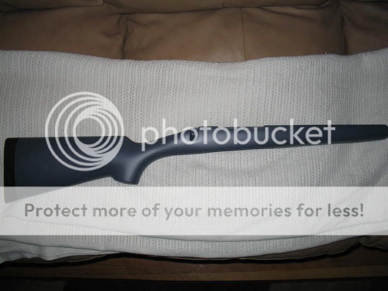

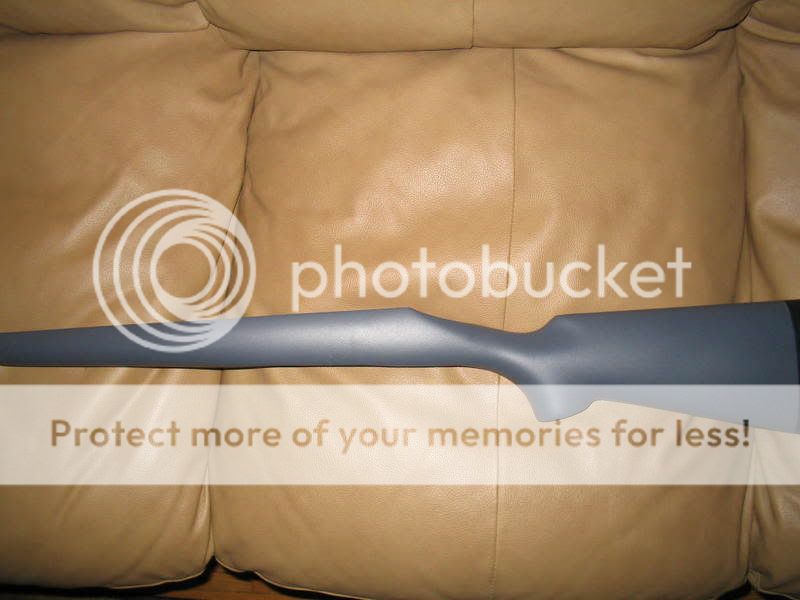

So now I'm getting ready to finish off a custom rifle and I am taking the stock off my mountain rifle and putting it on my Rem 700 TI custom 280AI.
I felt that the battleship grey was a little too bright for my hunting needs so I wanted to darken it up a bit while maintaining the bluish battleship tinge
I hit the sock with Fine recycled glass grit and then lightly sanded off the surface and remaining paint with 180 grit paper. After masking off the bedding
I then sprayed the stock with Nason 421-19 sandable urethane primer, real tough stuff. Then block sanded it with 400 grit paper. It takes a while but its worth it.
After cleaning off all the sanding dust I sprayed it with a home blend of 2 Armacoat colors Battleship grey and Matte black. If anyone wants the recipe PM me and I'll share.
I'm using a HVLP gun, this limits the amount of waste spray an just play with the settings until you get the finish you want.
This armacoat is very easy to spray, doesn't run very easily but is not thick at the same time, Great stuff. You can use an airbrush if you want but it will take forever apparently since your coverage is so fine.
Here she is. Now I am trying to decide what accent color to put on. I'm thinking either
1.) Darker spittle texture finish
2.) lighter spittle texture finish
3.) white webbing
4.) Black webbing
5.) Leave it as is
6.) Hunter orange poka dots, NOT
