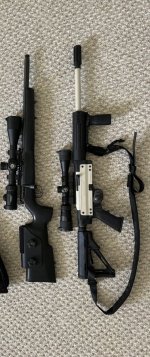

I did it before to rework rust on the bottom of the action but I wasn’t sure if I should because of how the barrel will be visibly matching the the unpainted action which I don’t really want to paint cause of all the markings and stuff

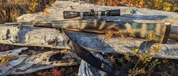

I've redone my stainless ever couple of years just for fun. Brown, black, even did a fake fluted look. A splatter camo go the longest with out neding a tuch up. FYI, As far as I could find rustoleum and tremclad come from the same facility.
I used gloss black on the action then I sanded it lightly with 600 grit after 24 hours and it matched the previous colour pretty well
Can u share pics of the fluted look
