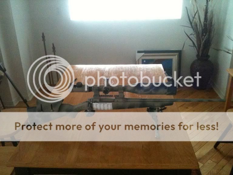

A Cooey60 I did up a few years back. I still gotta do the scope sometime.
Zimbu...that's WICKED...with a capitol WICK!!.:rockOn:..if you pull that scope OFF that gun...and left it in that tree, turned around three times.....you wouldn't find it again till spring!!.:evil:..Niiiice Work!!
Did you airbrush it or paint brush it on and did you satin(gloss)clear coat it to make it more durable ??...Thankx for sharing!!
Damn nice job. I always like to see the personal touch as apposed to "professionally produced" stuff. That just comes down to money. No slight to that method. I just like to see how creative people can be.
SRSA311
It took me maybe four evenings to complete, one of which was with the paint brushes. I started with a good coat of epoxy primer. I had some problems with the flat white Krylon cracking so I had to sand it down and try again with thinner coats. I've never had problems with Krylon before, but the coverage of the white was very poor so I probably put too much on at once. The branches were painted on with a $17 brush assortment (suitable for acrylic) from the craft store. I used desert sand, black, white, and red Krylon sprayed into a cup in varying ratios, followed by a clearcoat. I was planning to use Endura or automotive Dupont clearcoat for durability, but I got lazy and spraybombed the satin clear too.
