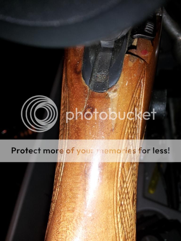

My father gave me his 308 Parker Hale when I first started deer hunting, he uses a Parker Hale 270 and between our rifles we have taken many deer and coyotes over the years. Unfortunately the stock has started to crack just behind the receiver and my 3/4 moa rifle has now become an 8.5 × 11 piece of paper moa rifle. I'm not opposed to a synthetic stock but this rifle had nice blonde wood and I'd like to keep that look if feasible.
Firstly. It has no model markings, only that it was made in England. How do I decipher which model it is?
Second. What are my most cost effective options to fixing or replacing this stock?
Thanks for your help
Ian
It looks like a model 1200 and the crack is very common on P-H rifles, especially on the 1200 series.
If you stop shooting it now and if you are skilled in woodworking, you can probably fix it with some work. If not, a competent gunsmith can fit it for you no problem.
If you want a replacement stock, you have to look for "commercial Mausers" or FN Mauser or even Parker Hale.... I do have some stocks in the EE expressely for the P-H action, but they are not finished and need some work.
The stock should be glass bedded and repaired from the inside behind and undernieth of the tang. It cracked because the action moved in the stock at the recoil lug airea
Even if you buy a new stock, I would have that one repaired; I love the look of the original Parker Hale stocks. I have a PH 1200CM in 7mm Rem MAG and it is my go-to rifle for hunting. AND, I'm another Ian. ;)
Thanks for your help. With your direction I was able to figure out it's a Parker Hale M1200C. Now that I know the official designation I can start searching for a replacement stock and get some quotes on restoring it.
