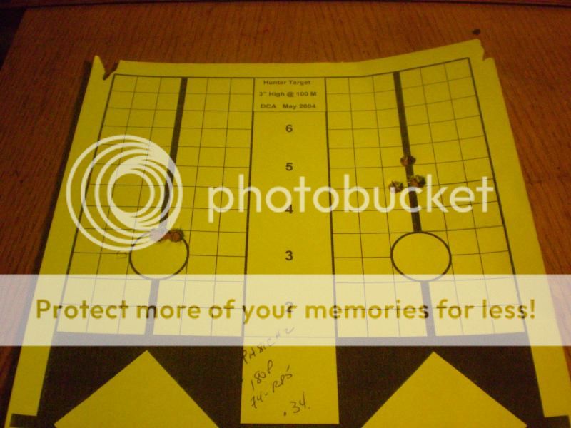

So I downloaded a picture of the two targets with the 180 partition and Norma MRP. (RP-5)
The right target was shot first. [3 shots, 5/8" C to C]
The left was shot with the remaining two shots of that load after cooldown and scope adjustment.
Regards, Eagleye.
