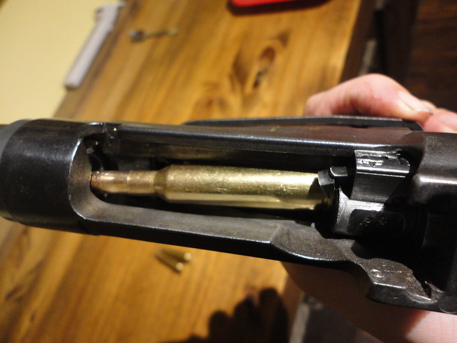

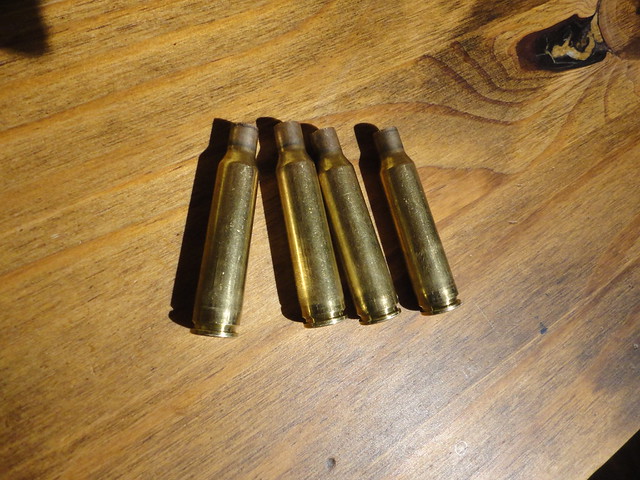

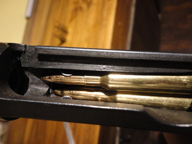

so this rifle has been around the block, so to say, I got it as a sporter no5mk1, then I restored it, then I re barreled it to 44-40 and now I'm turning it into a light weight mountain rifle I hope to take goat hunting some year.

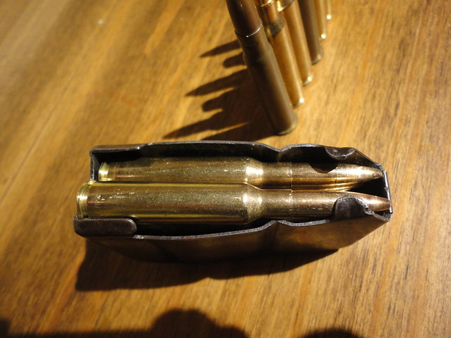

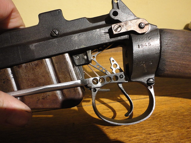

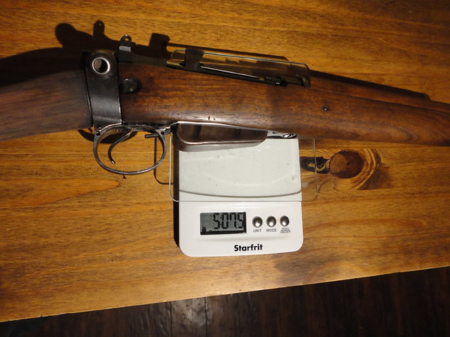

its has a AG42 barrel on it, chambered in 6.5x55. I lightened up some extra no 4 parts I had sitting around (trigger, sear, mag release and trigger guard) and got them quite a bit lighter then the no5 parts (half the weight)

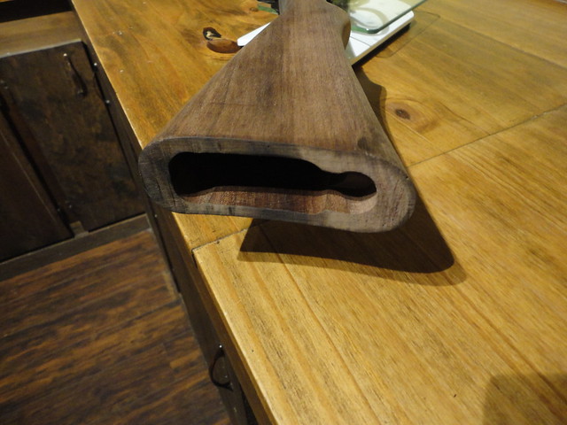

I'm going for a max of 6.5 pounds with the scope and mount. I don't have the butt stock finished, but ill be using a no4 butt stock and lightening it quite a bit in the same was the no5's were but a bit more and ill use a thin aluminum butt plate
with the no5 butt stock it still is below 6 pounds. so I figure 5.5 is doable but I don't want to ruin any no5 parts in this process.

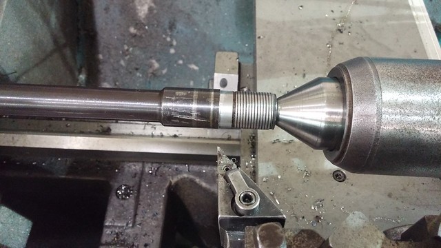

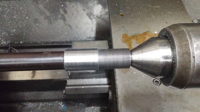

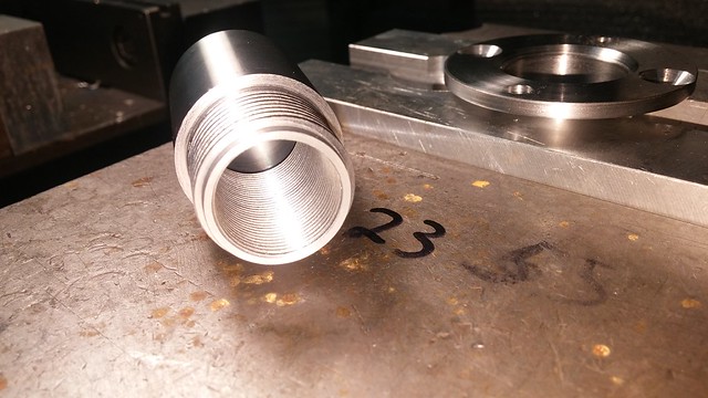

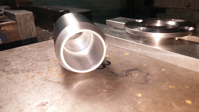

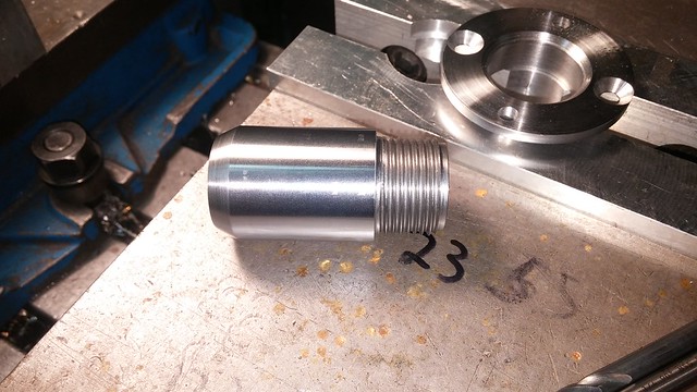

the barrel is attached to the receiver with a barrel nut I made of 4140, its m20x1 id and 14x1" 55* od, the barrel threads to a shoulder in the nut and the nut then threads to a shoulder it self.

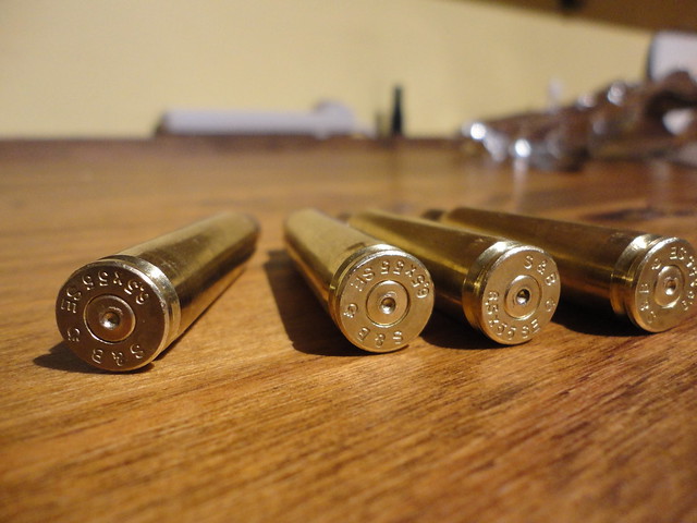

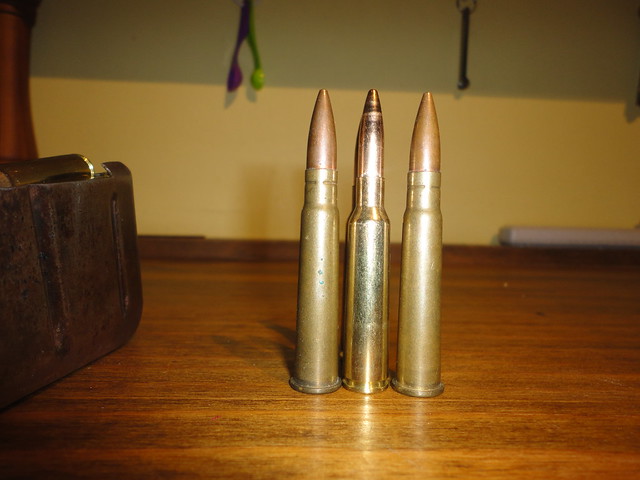

I plan to load 140gr bullets for 2500fps, I not sure what bullets ill use yet, I shoot cast in most thing I own.

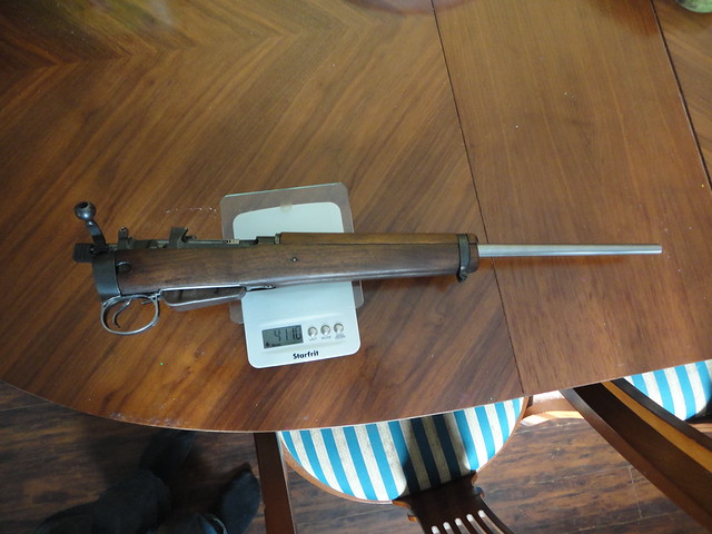

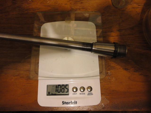

right now with out the butt stock it and butt stock bolt, it weights 4 pounds 11 oz,
total cost so far was 55$ for the barrel shipped
