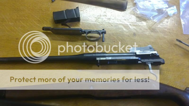

I recieved the barrelled action from a fair condition P14 bought from our friends at Ellwood Epps. It came to me fitted in a sporter stock. The rifle was mismatched, with a Remington action and a Winchester bolt. Nothing fancy about it. Condition was listed as fair, as was the price asked. The front sight 'ears' had been cut and filed. Rear sight was still in tact. No hack job to the barrel, no D&T. Basically a great candidate for some restoring.

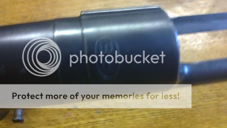

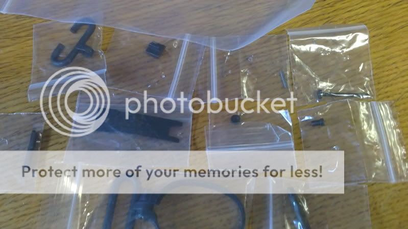

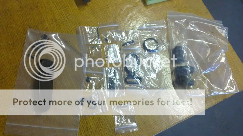

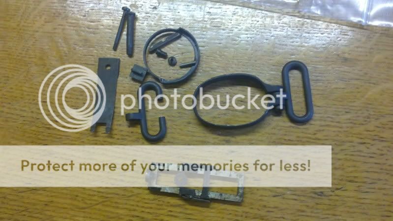

The metal bits came from various suppliers, principally Numrich. In the pictures you'll see the front barrel band which doubles as a platform for the bayonet lug, the upper band screw, rear barrel band with sling swivel, a stacking swivel, a front sight blade, front sight carrier, front sight spline, front sight pin, a handguard ring, butt plate, and various parts for a rear sight assembly (rear sight axis nut, axis screw, base screw, base spring, and of course the actual sight itself with elevator).

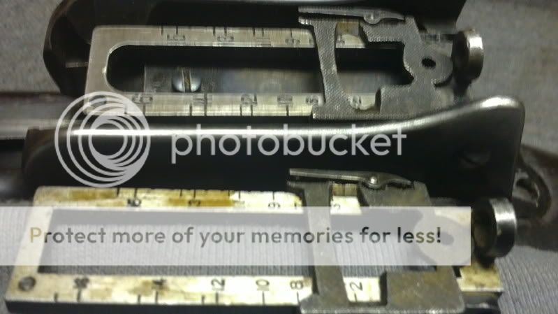

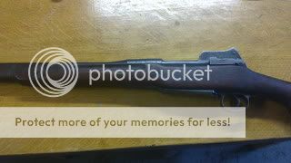

Now if you were paying attention, you may have noticed I already had a rear sight. The other is (hopefully) an M1917 Enfield sight from Winchester. As you can see the two have slightly different numbering, which may be a due to the different factories, but I'm hoping it's a 303 vs 30-06 thing. I'm sure if I took a tiny ruler I could see if the notches are different. I have a sporter 1917 Enfield which lacks the original military sights, hence the purchase. But that's for another time.

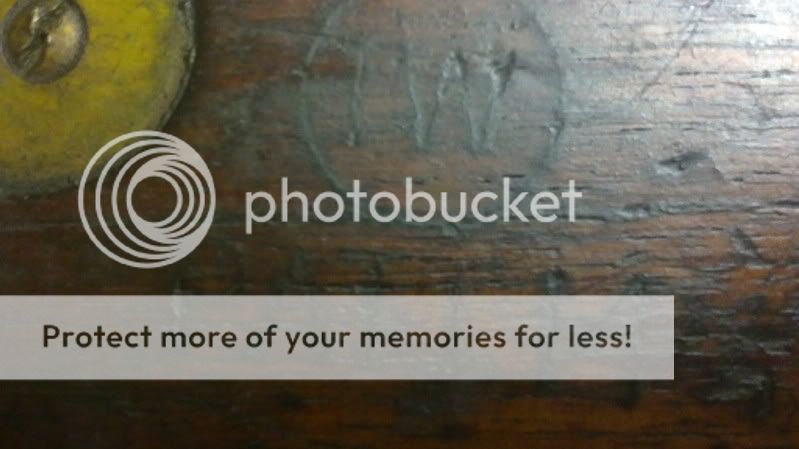

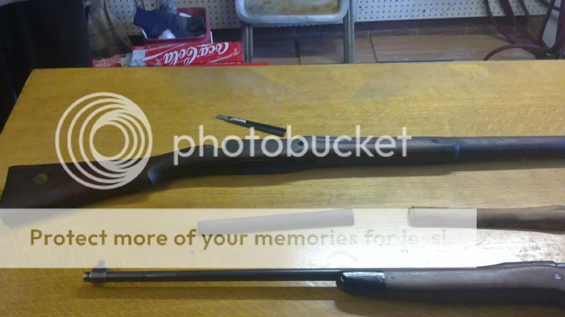

The replacement stock was in good condition. Covered in various scratches, the lettering is still readable next to the brass disc. The volley sight disc is still there, though the rare arm piece isn't. Looks like something that saw some use. There was a repair done at some point to the butt, that unfortunately is a fraction off of the original. It'll take some work to get the butt plate to fit that properly.

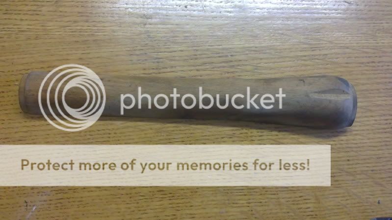

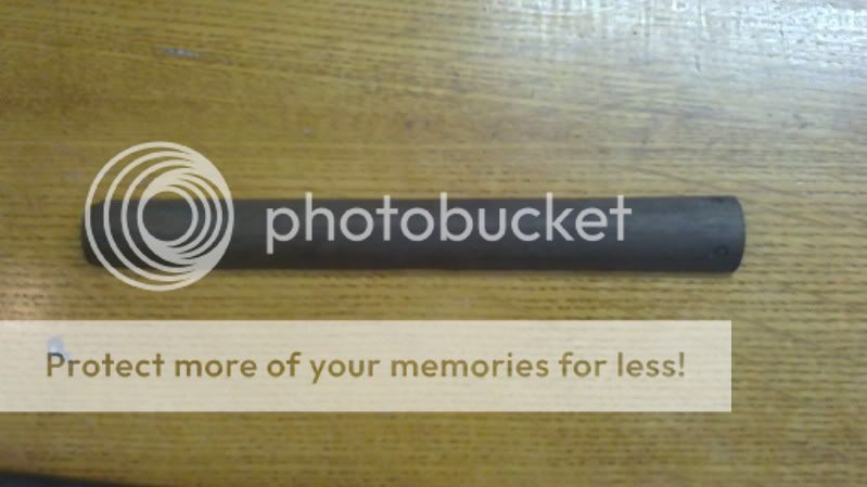

The hand guard portions look like they were never issued to the point that they're lacking finish. I'll have to grab some Linseed oil and make them better match.

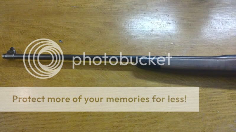

The rifle popped out of the old sporter stock...

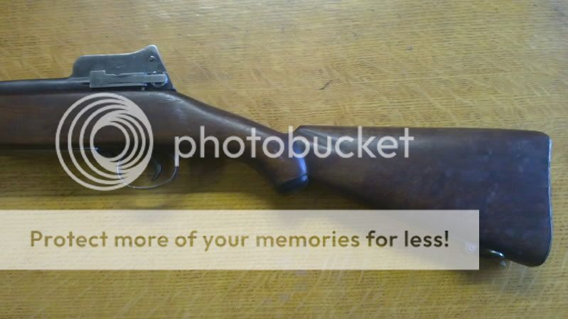

...and into the replacement like a glove.
Then I realized I'd forgotten to put the handguard ring on, so off the stock came.

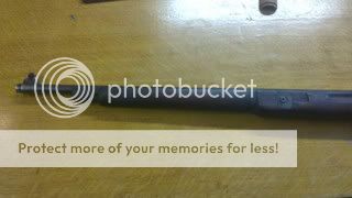

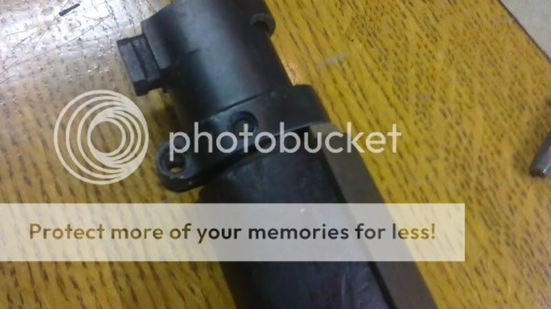

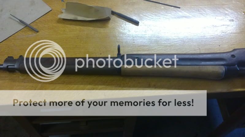

On went the ring, and on went the handguards, followed buy the bands.
Unfortunately due to nearly 100 years of storage and moisture, the handguard wood was a little bit fussy, so a little bit of sanding was required (very minimal) and the front band eventually tapped on very snug.

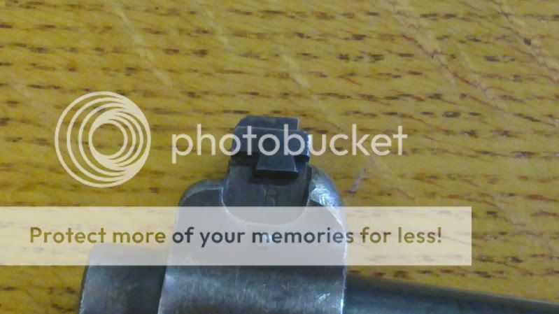

The old front sight had to be replaced, since the 'ears' were missing.

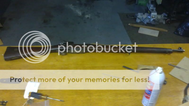

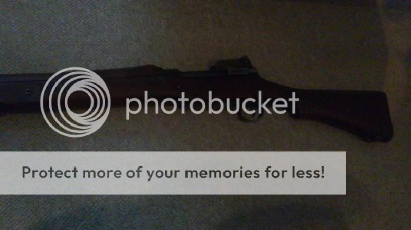

And so far here we are:

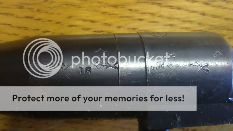

Pending the replacement of the buttplate and a refinishing of the handguards, I've got myself a nicely frankensteined Pattern 14 Enfield. Winchester, Remington, and Eddystone stamps can be found all over the various parts. I'm sure some parts were originally for an M1917, but they met up without too much fuss.

Nice job. I like those rifles a lot. A little walnut stain on that handguard before you BLO it might make it match better.

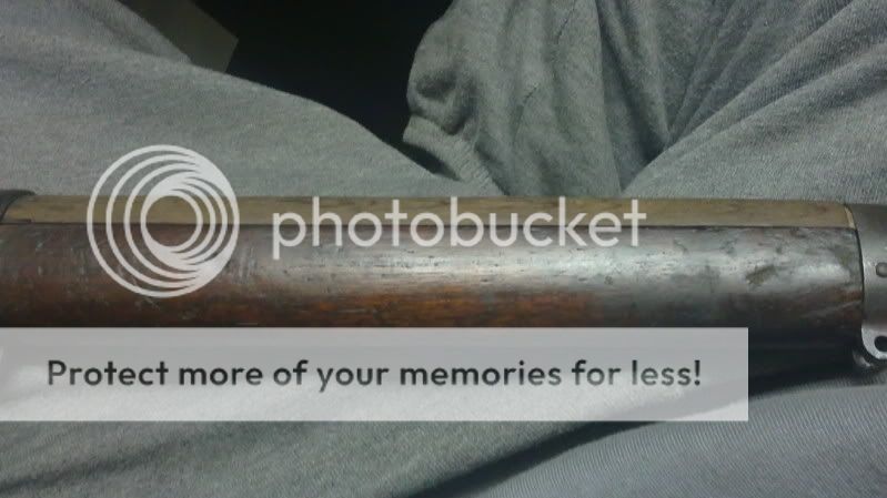

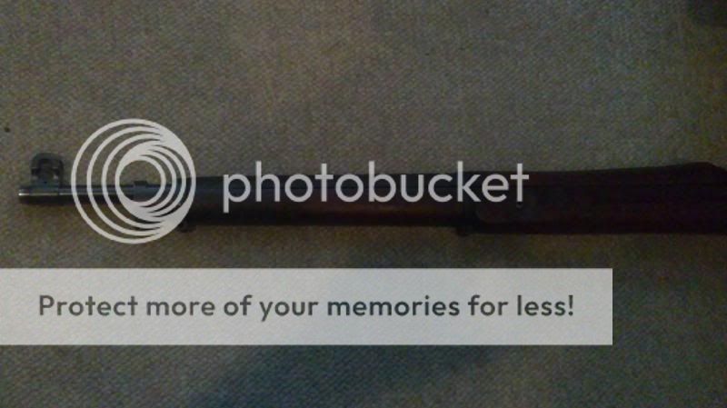

I completely forgot about this one. I'm in the middle of packing for something, but I've taken a few quick photos. It worked out fine, stain went on without a hitch, I learned a thing or two about Boiled Linseed Oil (be sure to wipe the excess off, especially the edges where the droplets will collect).

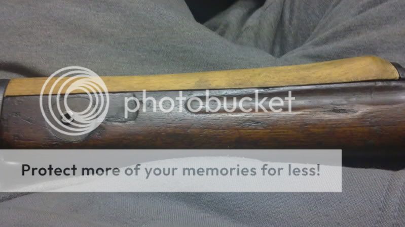

As you can see, my camera isn't good. But the stain matched the original finish quite nicely. The rear handguard is the only real troublemaker. From the photo, you can see a noticable gap as it moves closer to the reciever. Perhaps that's why the handguard was never used until now.
I'll try to follow up with more detailed photos later in the week. If I remember...

From what I can see, you still need the front stacking swivel and stacking screw :redface:
They're somewhere around here. I moved about 2 months ago and all of my odds and ends for the rebuild are still in storage. Really threw me off track for the rebuild and I've been distracted by other things. I know it's in a plastic baggie with the label 'P14 stuff'...
In order to get the hand guard tighter, what would you have to do? Remove wood from the inside to get it to drop down farther? Would it then be loose until you build it up under the ring to make it tight again?
Just thinking out loud...
The hand guard gap can be caused by three different issues.
1. It could be that the hand guard itself has been sanded on the bottom of the flats. Easy to tell... if the flats look like they have been milled and are flat with sharp edges on the inside then they likely haven't been touched.
2. The top of the stock flats have been sanded. Again, machine tooling marks or absence there will provide the answer.
3. It could be that the action does not sit low enough in the stock. Possibly there is not enough relief in the stock for the hand guard retainer.
I believe you said that you had good barrel tension, so #3 is probably not the cause, but it wouldn't hurt to check all three.
