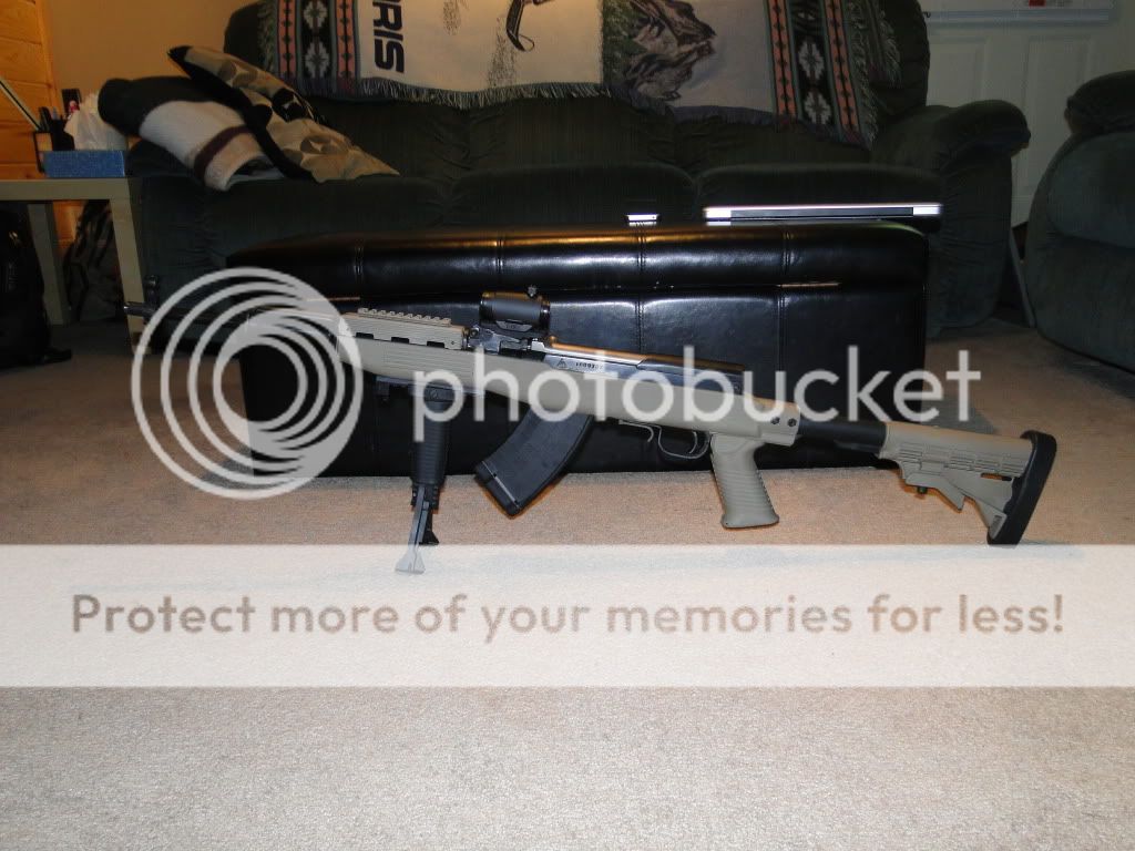

Pave's new SKS... literally NEW
Some people like things stock and like things modded. This looks good to me. But I also like stock sks.

Got my latest parts shipment in and did a bit of modding this afternoon.

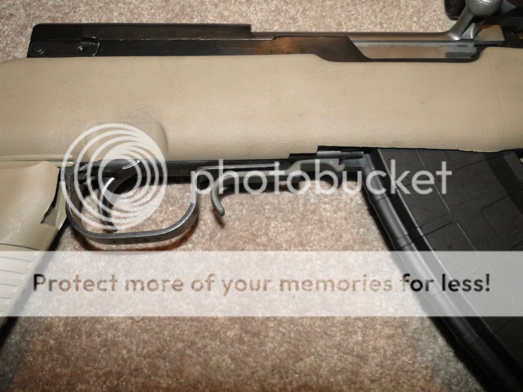

I installed a Tapco rubber butt pad, a BC Scout mount, a Truly Tactical extended mag release and a new micro red/green dot. Everything went together as smooth as it always does. No issues or hang ups at all. Very nice parts, all of them.

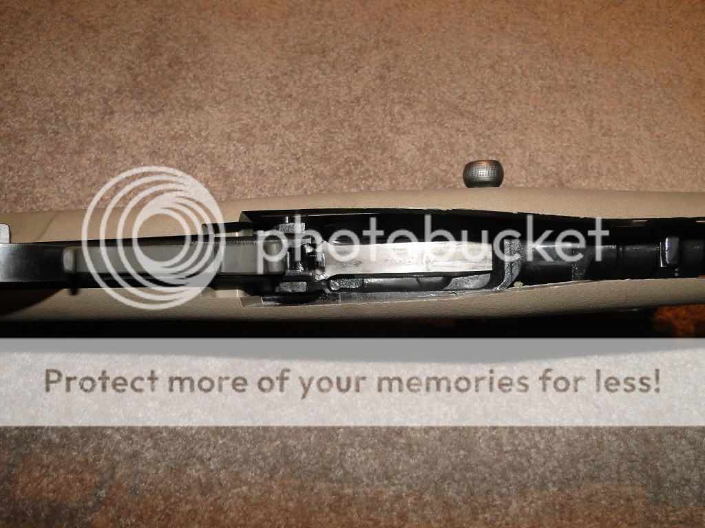

Then, I decided to do some bubba work and did the closed bolt mod. It wasnt hard at all but did take some time to get the shaved areas smooth. I also cut off my barrel to 18.5 inches. This is SERIOUS bubba stuff... hehe. But I just acquired a Ruger Mini-30 so if I want a super accurate gun, ill use that. My SKS is just for fun shooting so I wanted it to look better. I think I did a decent job of it. Re-crowned it myself as best I could. Hopefully ill get out and do some shooting this weekend to see if its at all accurate.

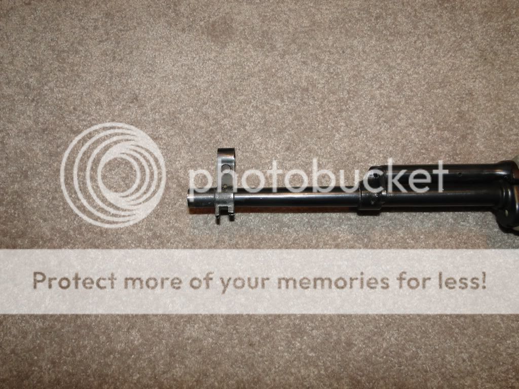

I removed the front sight/bayonet mount and cut the bayonet part off, then turned what was left around and re-installed it on the barrel and re-pinned it so it looks a bit more finished rather than just having the barrel end with nothing. I think it looks pretty good.

Ive also got a few more goodies I want to add to this gun. I think I'm going to remove the fore grip, I've got a bi-pod to go on instead and I think ill add one of those angled fore grips at the back of the lower rail. Finally, I'm liking the look of the vented gas tube cover you can get for it in place of the Tapco upper part. Not %100 sure on that yet but thats where I'm leaning.
Finally, I got a pin on break that SHOULD fit on my shortened barrel... may require some more modding but it should finish off the look of the end of the barrel.
I just picked up a few different cheek rest options from a store called Israel Defense on e-bay. They apparently will fit right on the tapco stock. They were pretty cheap and shipping was only $4 each so I got a couple options. figure ill find a use for them somewhere down the road. Ill post pics once I get them. Hopefully no issues with shipping. The store said they ship to canada so we'll see.
Nice work. Did you have to drill another slot for the pin or was the existing one in the right place? For the front sight I mean. I almost want to try a tapco'd SKS now...
Had to drill another slot but I used the hole in the front sight as a guide and just went lightly with the bit to the other side. Pin fit really tight but I did get it in there. I think with the break I've got coming it really should finish off the front of the gun nicely.
I have been looking at 1X14 reverse threading kits though which would allow me to use an AK threaded break. Im just not sure I want to go that far, but its definitely the next thing on the list.

CNC Warrior has threading dies and die starters in M14X1 RH and LH. You could go RH and use VZ58 muzzles. Probably easier to source in Canada with ITAR cutting us off.
