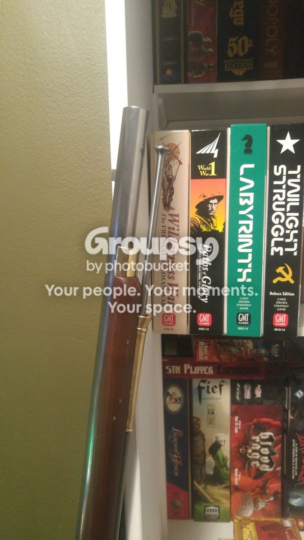

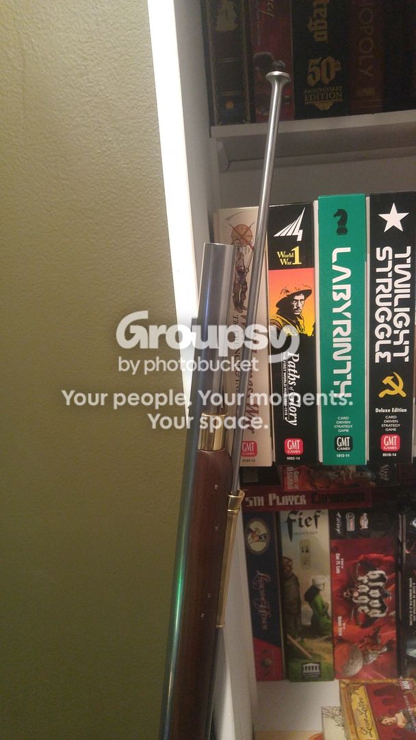

I don't want to make any alterations for the musket itself, but I thought about trying to take some metal off of the ramrod to make it a little thinner. Here are some photos. The first shows the ramrod fully inserted as far as it goes. The second shows where the tough resistance starts. (meaning what I feel is unreasonable tightness)

There is a spring located in the stock that applies pressure to the ram rod to stop it from sliding out of the ram rod pipes. I suggest you inspect it to see if you can reduce the pressure. If thats the problem...

Is the ramrod straight? As SJ says check the retention spring and also see if there is any debris in the channel. If they are good hone out the pipe with 200/400 paper slowly. You do not want the ramrod to be siding out on its own.

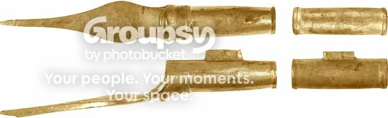

I have inspected the underside of the musket, with flashlight, done many google searches and found no clear information where the spring would be located, but I'd assume it would be IN the rear thimble as it's called on the Pedersoli plans. A picture to confirm the specific part.
I assume I'd have to take the pin out from the stock to gain access to it, something I'm very hesitant to do as I haven't even fired the musket. I really don't want to risk breaking anything just yet.

I definitely will. I only did a quick search for a group and one did come up. I never thought of checking if the rod were straight, so I rolled it on my table like a billiards cue and yes it did wobble a bit. I found the bend and bent it a little more straight. However this didn't solve the problem. It seems that this spring is just a little too tight. As for debris, when I retrieve the rod, there doesn't appear to be any on the rod. I however need a better, smaller flash light to get a good look.

Well, with the rod fully inserted (not just flush with barrel), I can hold the rod, pick up the musket (by holding only the rod) shake it about, moving up and down with sudden movements and it will only budge slightly, maybe coming out half an inch at a time. And I mean, I was fairly violently doing this. The musket is beautiful. As mentioned, I haven't fired it yet, but I don't think I'd be too mad if I didn't. Just a wonderful piece of history to have.
