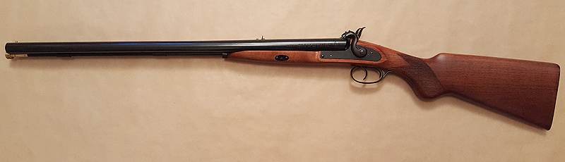

Well, today I was finally able to shoot and pattern my muzzle loading shotgun, a Perdersoli 12ga Slug gun, … and in preparation for this years’s deer hunting season.
The gun is advertised as a 12ga …. without chokes … so cylinder bore. But the gun is really more of a 13ga … I had 12ga and 13ga nitro cards and fiber wads ... and the 13ga ones did fit. I was never able to push the 12ga ones down the barrels.

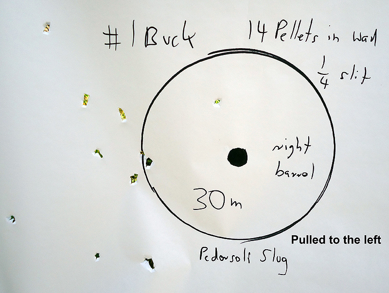

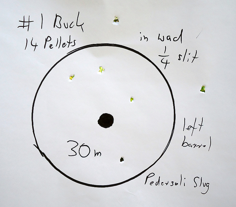

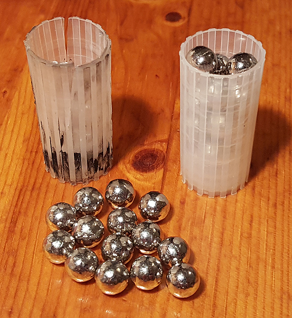

4.) And then I tried #1 Buckshot … 14 nickel plated pellets in a BP12 plastic wad (slit 1/4 down) … with 90 grains of Pyrodex …. and that load showed some promises.
The left wad was shot, and the right one is new with 14 pellets #1 Buck stacked in it.
And here the result ( 9 inch circle / pie plate ):
Voila, my first steps in the muzzle loading land .... never shot a muzzle loader before.
Now my question is …. has anybody any experience of how to tighten up that group further?? Keep in mind that this is a muzzle loader without a choke …. Fixed cylinder bore !!!
Other input?
Right now I consider this a 25 meter gun for whitetail hunting. How can I make this a 30+ meter gun ... ?
