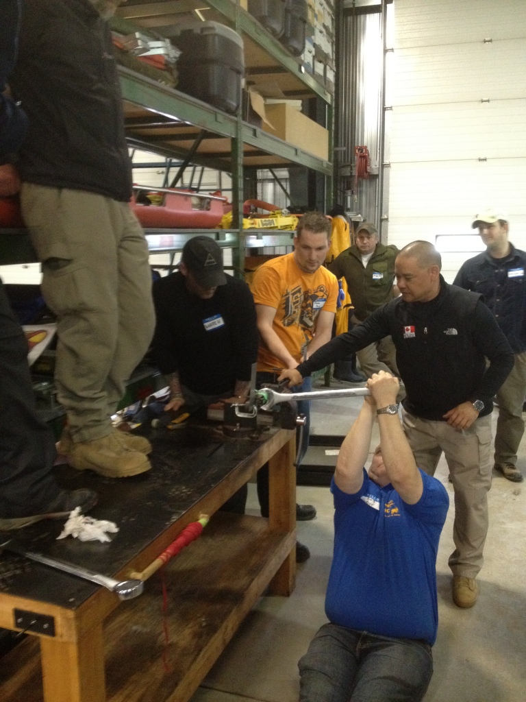

So it was put together and indexed with over 14 sets of eyes to ensure their approval that the parallels used to index the barrel and receiver were not lying. Life is good. We took about 1/2 hour for this operation. You can see by the pics that we had a couple of CGNutters UP on the workbench to counter the enormous torque we placed on that receiver in order to ensure a top dead center indexing job. :D
Here we are screwing the barrel on the M1A receiver (hey, where's Seafury? I gotta show this rifle to him) that I just bought from the EE Forum here of a fantastic CGNutter "RR" from Alberta- Biggest THANKS for the smooth deal and the Jan 1989 made Springfield Armory M1A.
