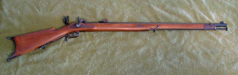

Though not a real long range gun here is one of my favourite guns a Swiss 1851 Stutzer 41cal made by v vollmer
