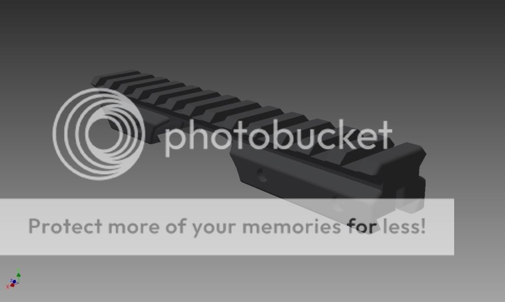

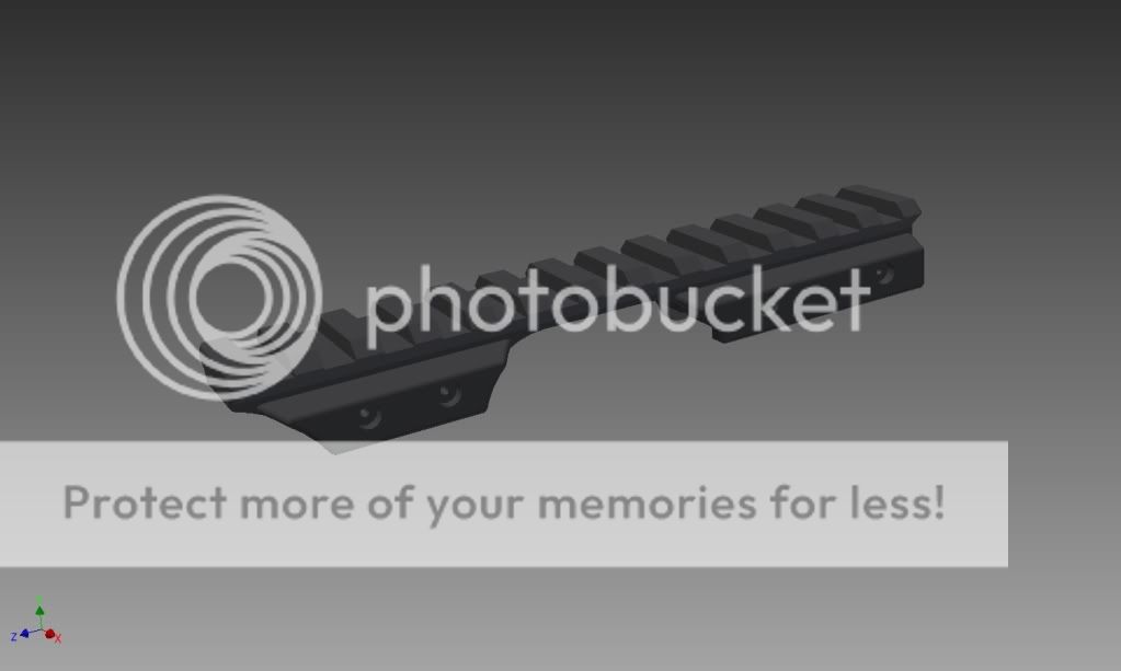

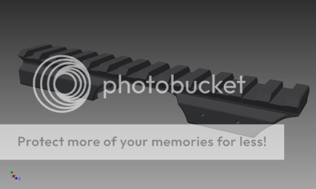

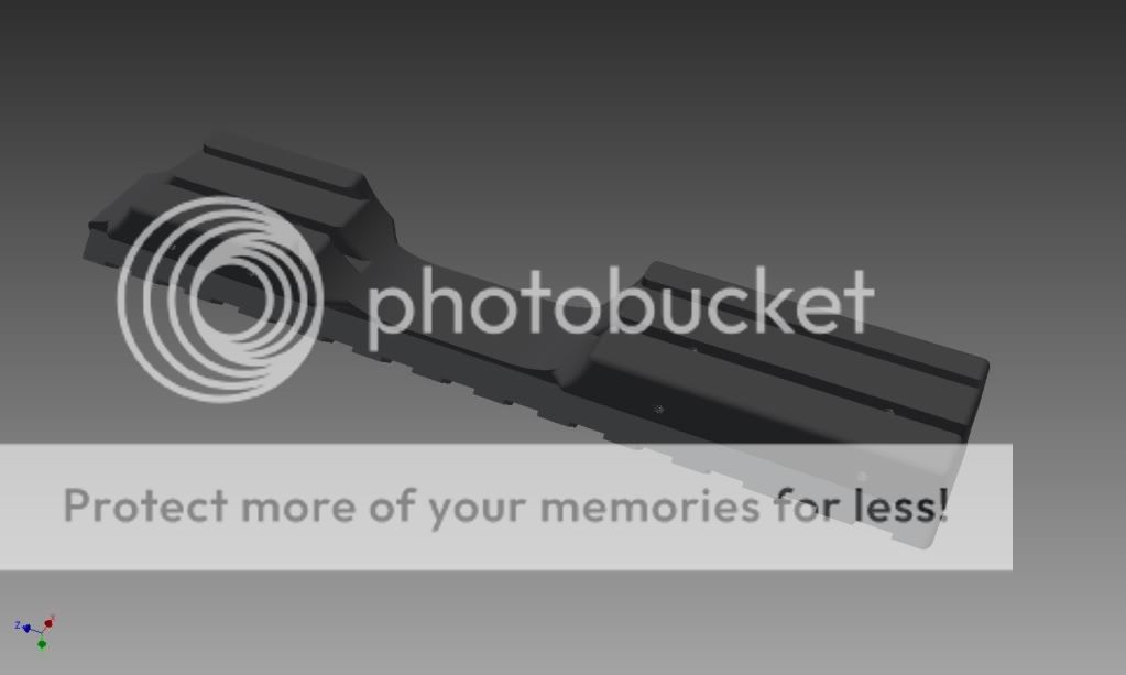

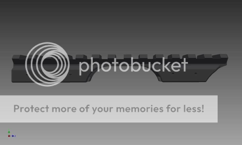

So I set out to design my own. Here's some pictures from Autodesk Inventor:
So, this unit will clamp right onto the Brno dovetails (no drilling or tapping) and is 5.25" long and sits 0.6" high above the receiver. It'll use M2x0.4 socket head cap screws (allen keys) to tighten the full length of the receiver.
I've been looking around to get a few of these built out of steel (but may end up being anodized aluminum) and I'm wondering if anybody else would be interested in one.
If I can get 50 people who want one, I could get the price down to approximately $80 each.
Anybody interested or know of any other fabrication shops that might be interested in building these for me?
PM me if you're interested in one or post if you had any comments!
