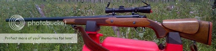

I would be hesitant to put a picatinny on my 85's (or AV) because it would upset aesthetics and balance. I'm well aware that some scopes I've considered won't fit without extensions of some kind. However, I've settled on scopes that fit and suit my rifles just fine.
375 H&H Magnum Sako 85 Kodiak with Leupold VX-2 Ultralight 3-9x33mm scope
300 Win. Mag. Sako 85 Grey Wolf with Nikon Monarch III 4-16x42mm scope
458 Lott Sako AV Hunter with Leupold VX-2 1-4x20mm scope
I have a similar ring setup. I'm currently using Leupold Medium height 1" rings. The scope is as far back as can possibly be. As a person with a thicker chest than average, I find myself needing to set up my scope further back than most. Either that or I shorten the length of pull on the stock. For example, I have a McMillan A5 on a .308 and I use it with all the spacers removed. My current scope setup is acceptable but not perfect, about 1/2" too far forward. On a rifle that price, I'd want it perfect. I like how your 1-4x20 is set up. Still room to push it back a little. I'm likely to go with a similar setup in the future if I decide against the rail.

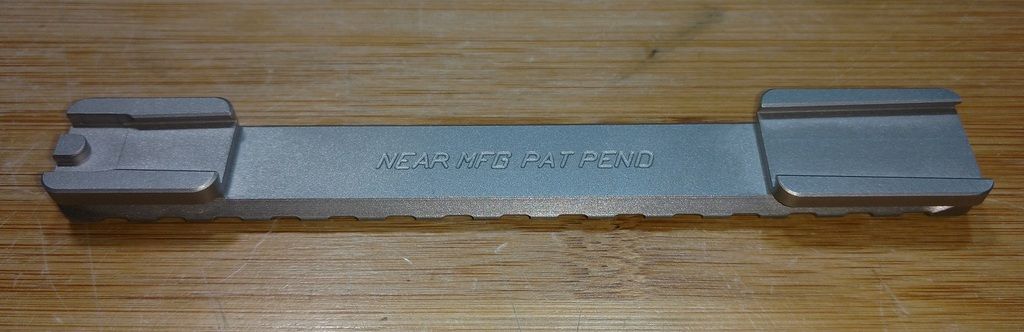

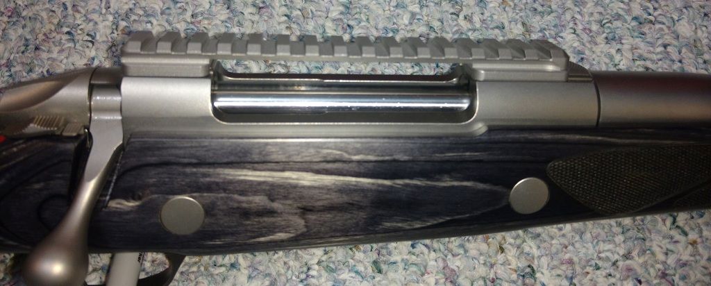

So the new NEAR Manufacturing rail is here! Richard is definitely top notch. I was expecting a bit of a lead time but he must have had it in stock, he shipped the next day! I went with the SS 0 MOA rail. Fit and finish are perfect. Mounting was a breeze. Some sanding was involved but in the end I got a perfect custom fit. The rail is now fully seated, some of the pictures show a small gap. This thing is press fitted and fells welded in place. Best part was no screws and no drill and tap!

You know, by the harsh laws of fits and tolerances, that thing shouldn't work. Glad it does! :)
So how is the ejection?!? What is the final scope height like?!? Details man!!!

Ejection is flawless. Without the rail I can make the dummies hit the ceiling. With the rail the shells fly at about head level and fall nicely to the side, not in the next time zone. Don't know how it dings empty cases yet, will know when I hit the range.
The rail adds about .335" in the front and .350" in the rear in height. That's from top of Sako dovetail to top of rail. I'm in the process of selecting rings for my setup, now that I have a rail to work with there are many more possibilities.
