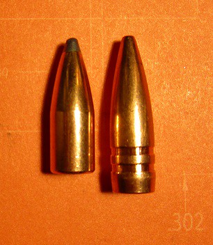

Here are some pictures. In this first picture you can see the three sets of rounds. The first three with the 1 on them in sharpie are 44.9 grains of 4166 the second three are 45.4 grains and the third are 45.9 grains. does this look like flattened primers to you? Or am i just being paranoid because i think the powder level is too high?

If someone could check their book for IMR 4166 and confirm this is where i should be for powder weight i would appreciate it. I also double checked my 44.9 grain set on my backup scale and my actual measurements are correct. Anyway if you think those primers dont look flattened then i have found the load i am going with. 45.5 grains....
