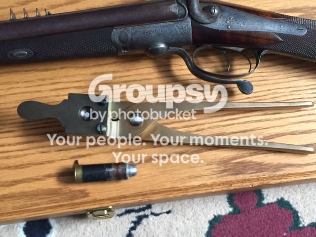

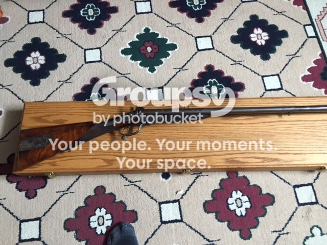

Wow guys thanks for the info, sorry that this has laid dormant I didn't notice responses to this. Pinfire you hit the nail (or pin? haha) on the head every thing you described matches the shotgun. I was wondering what 3A" meant (the A is over the " and both are superscript to the 3), and now I know. It is a Bastin style and I was wondering why "BASTIN FRERE BREVETES 598" is on the lever and "BASTIN FRERE 597" was on the bottom of the barrel/slide (it was hard to see.) I picked this up years ago (as you can see from the first post), unfortunately BEAUTIFUL stock has a chip near the receiver which luckily is a bit hidden. Ill post some pictures today and we can continue the conversation, also once I have posted the pictures can you let me know if you think it is Damascus steel or just looks like it?

here is the chip in the stock, its weird lighting I know but it was best view I felt:
[/url]IMG_20180121_151808 by O1 R1, on Flickr[/IMG]
Beautiful. Definitely composite (Damascus) steel barrels and rib. I have a G. Masu underlever centerfire 12 ga., address 10 Wigmore St. but can't post pics until back from refresh by CJDawe. Like yours is a back action with atypical checquer (but mine not same as your pattern at all). Very well made gun with some unique features that suggest Gustave did not necessarily go with the flow.
