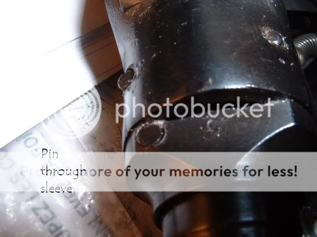

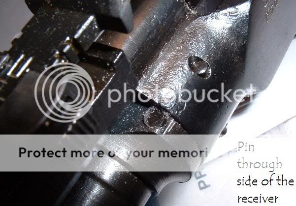

There was a particular batch last year or so which followed this pattern. 04 prefix serial numbers (commercial pattern Chinese serial -indicates year of manufacture) shortened barrel (18.5 if memory serves) no bayonets and a rubber butt pad in place of the normal steel one. The Simonov page will not list this variation because this is a recent modification which cannot be imported into the US.
Initially only one pin was used on this series but Lever recalled them for a second pin to be installed. Note that the pins go vertically on each side of the receiver. On the military pinned barrel model, the single pin used is much larger and goes horizontally through the lower receiver. As well the barrel on that (military pinned) model does not have an enlarged chamber shoulder area but keeps the same contour into the receiver.
It would seem that current imports are of the military variety with mil spec parts.
Here are some pics of the 04 series commercial SKS sent to me by another member last year:
