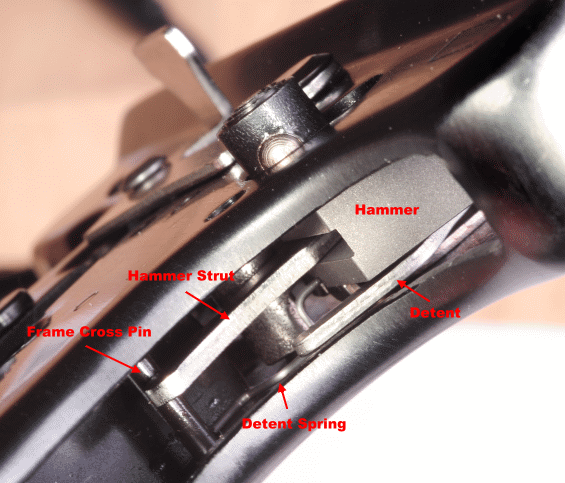

Thanks for all the help, i think you guys may have bailed me out. OK, so here's an update. i had to remove the pin that was holding the hammer in the frame, wiggled and waggled and got the thing taken apart. After getting it back together now its not cycling properly. it cocks and firers no problem, but as i pull the slide back it starts getting very stiff and binds like somethings not lined up right. I've taken apart several time looking for rub mark or something to tell me where its rubbing or grabbing . All i can come up with is, i think the hammer strut may have gotten bent while trying to get the gun apart. its got a slight half moon shape now and i think its suppose to have a curve on one side and be straight on the other but i don't have any frame of reference other then Brownells, but they only have the MK II hammer and i don't know if they are the same. i'm hoping someone might have some insight or maybe send me in the right direction or maybe if your feeling generous post a photo of your hammer strut!!!

Hope cellphone pics will do. The strut is curved slightly on 1 side and straight on the other. 2nd photo below shows the hammer at it's full forward position with the strut as far forward as it will rotate for reference.
Close Up:
Further Away:
