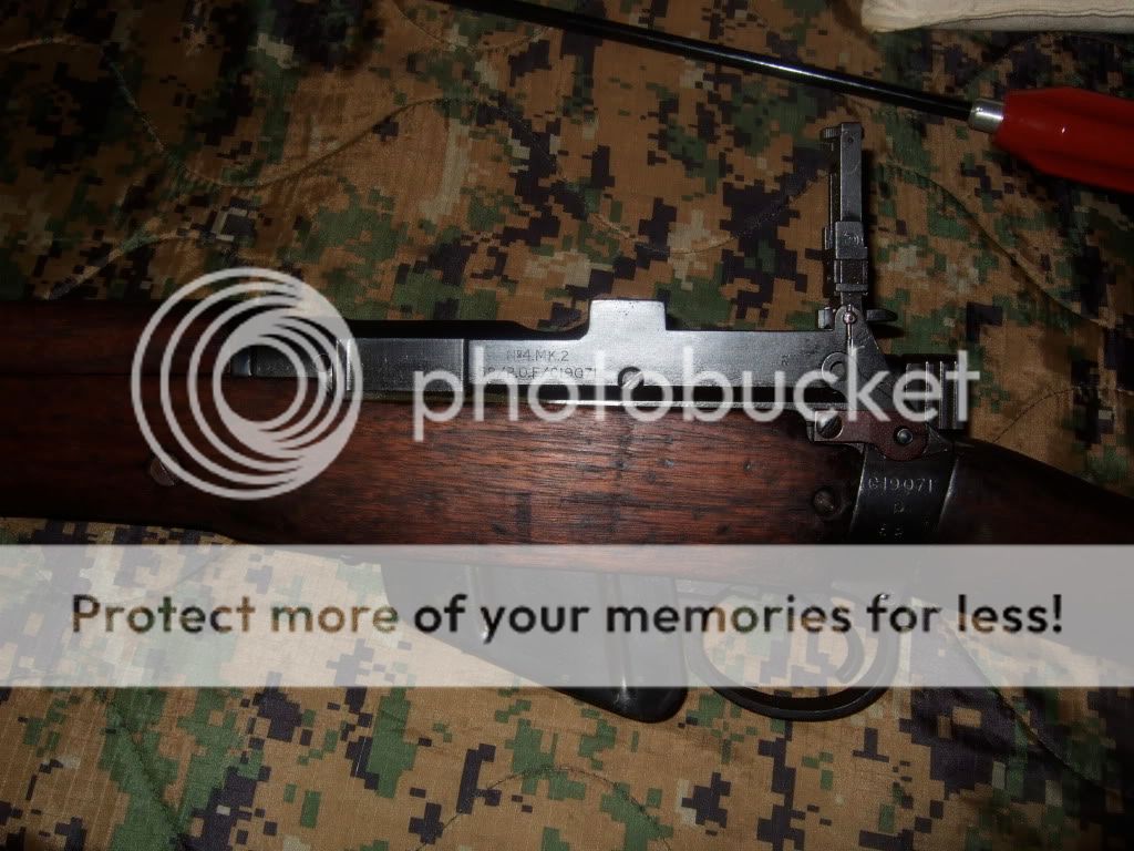

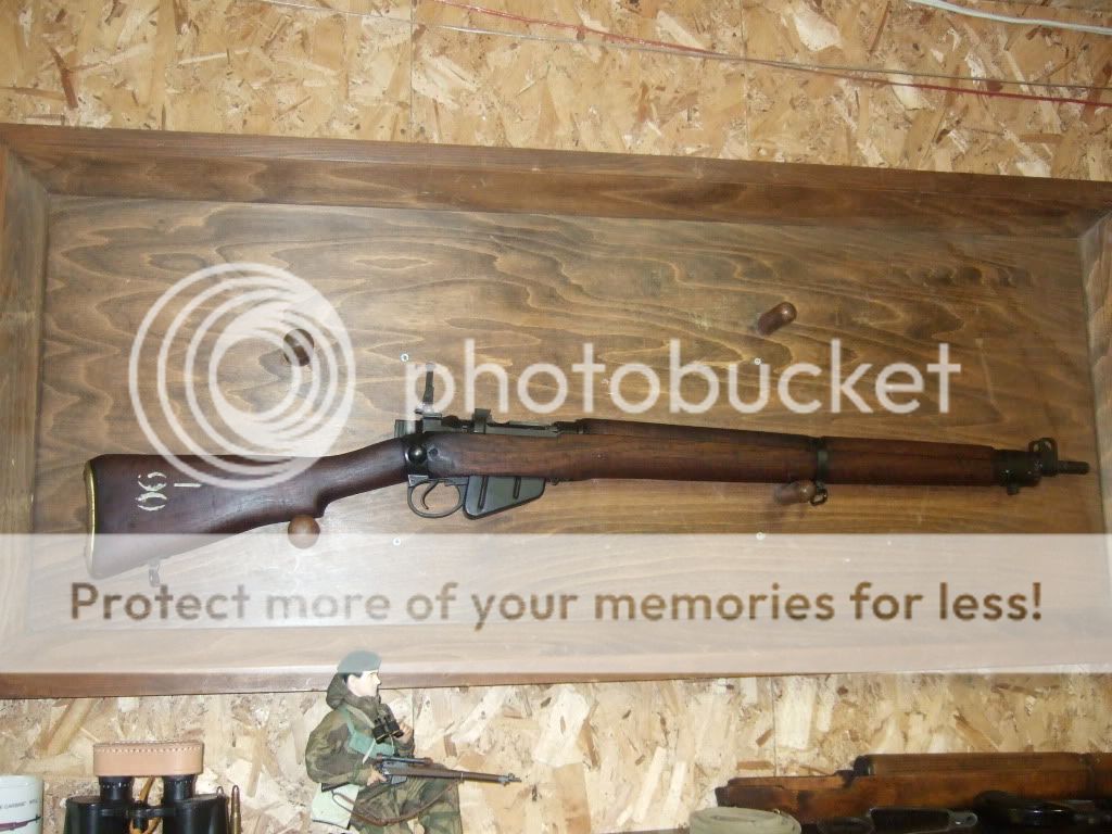

I picked up a 1958 POF Indian capture No4Mk2,After a thorough cleaning I have to admit Im happy.I read Fazakerly sold there machinery to Pakistan.It looks like they also bought as much surplus parts as possible.It sports a Faz 50 marked barrel and what looks like a Savage buttstock.Bore is good but it has a #2 bolthead.The mag is a Faz with a Singer platform but is numbered to the rifle.The wood looks like it was carved by a local using glass but does the job.The receiver and metal work has a nice finish,It sports the dreaded Ishapore screw indicating a capture.Interestingly the metal under the wood is painted green like the Brits did with there Jungle carbines,When I picked it up it was really grungy but no rust.For the price I dont think you will find another full wood No4Mk2.I will shoot it next week and let you know how it goes.I know Riflechair has a good writeup on the one he purchased as well.All and all a good buy and a must for the serious Enfield collector.http://i887.photobucket.com/albums/ac74/wanderingzero/DSCF2771.jpg http://i887.photobucket.com/albums/ac74/wanderingzero/DSCF2768.jpg

You've got the history down.....made in Pakistan and Indian capture. The screw is to reinforce the forend and prevent it from from splitting. Wood is "Luan" and has a walnut look however very straight grained and pron to failure.

Ok, a question here. Why does everyone spit upon this "ishapore screw". Is extra wood re-enforcement not good? Heck the Russians had been putting stock bolts in thier Mosins since the early 1900's if not earlier. Was this screw useless? What drawbacks did it have? Why (if it does), does it devalue the rifle? Finally, are Ishapore rifles really of such poor quality?

Drach, I have no problem with the screw. The Brits and maybe some of the other user countries used them as acceptable field repairs. They were changed out at first opportunity though. More snobbism than anything else IMHO.

The "Ishy Screw" concept actually is of British origin not Indian. These were applied for use in wet and humid locations - as I recall this was performed by regionally located weapon techs.
It was applied very widely in India mind you due to wood seperation forward of the King screw when the wood was wet. When wood gets wet it swells and becomes very soft. Wood, while under tension, while at the same time is expanding due to moisture swells and cracks.
That screw is there for a reason. Especiallly with lighter woods such as Luan Mahogany. If I were you chaps I'd get used to it. There is nothing "Unoriginal" about that screw. This is one of the quick fixes lee enfields require as a result of having only one action screw.
