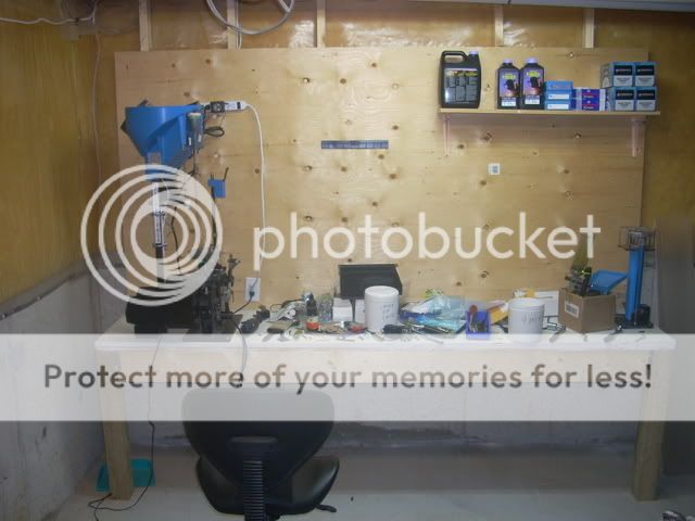

At RePete's suggestion, I've mounted the power bar up high, and tied up the extra cord. I can't keep the bench from getting dirty from tumbler media or splilled powder/primers, but at least it's easy to clean up like this with the clutter off the bench.
And speaking of clutter, the bench is currently a disaster. Previously, the press was on the right side of the bench. I left off adding shelving, other than the small one, so I could get a feel for the natural flow of tools and parts. Now I'm going to put 6' of shelving across the right side.
And here the beast is set up, the primer filler moved to it's final resting place, and the bench de-####ted.
