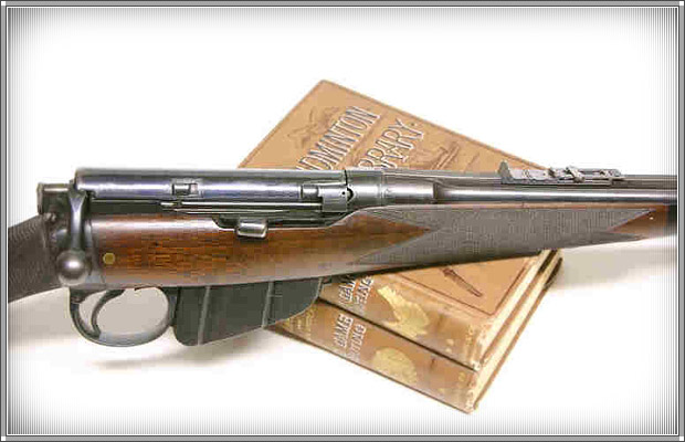

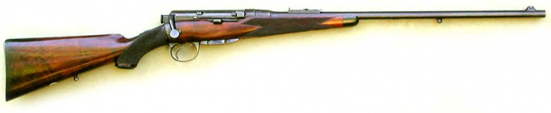

Or make a Lee Speed type sporter out of it. No point doing anything unless the rifling is really good however.
It always amazes me when I see one of those commercial Lee sporters. They are so elegant and graceful. And just about every one has the same pattern of backsight - one fixed blade, two folders, and a standup leaf. Saw the same sight on an A&N .303 double rifle.

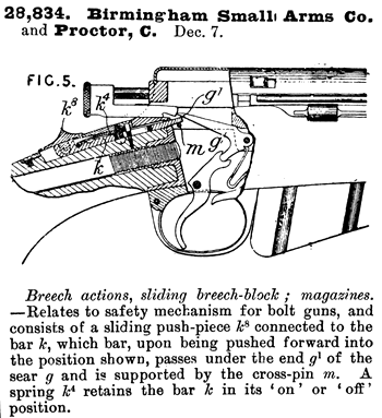

The tang safety on these rifles is very clever, and quite buildable. The thumbpiece is supported by an inletted plate, and activates a rectangular pushrod that passes through a matching hole in the web of the buttsocket. When pushed foreward, it blocks downward movement of the sear, locking it in engagement with the cocking piece. There is a detent spring under the thumbpiece, just like the one in many double shotguns.

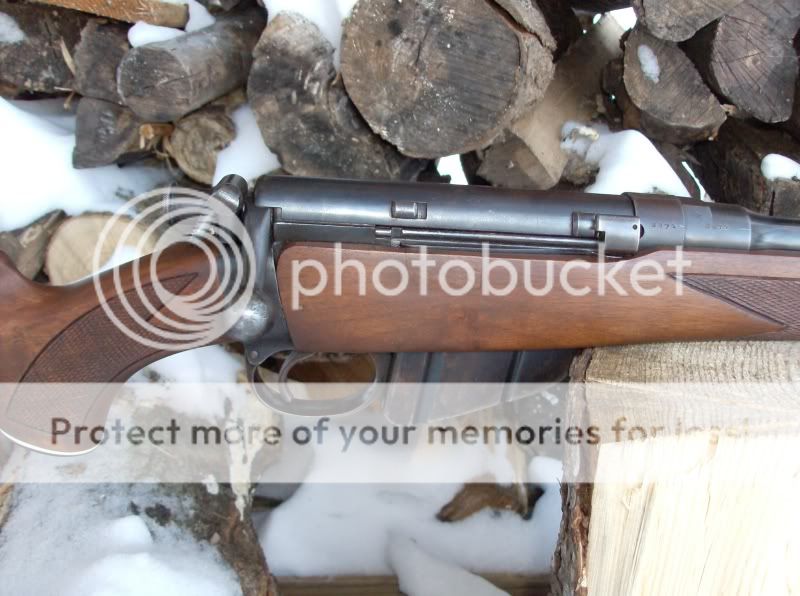

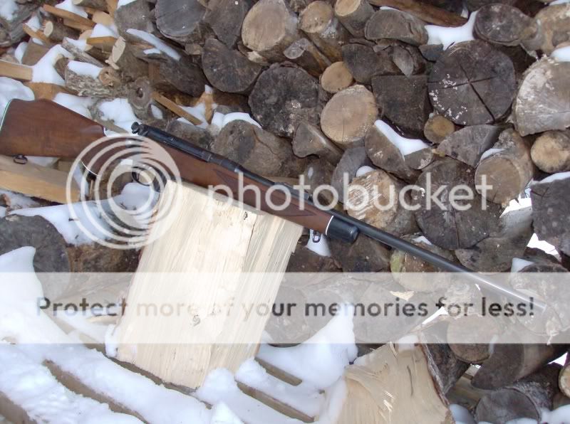

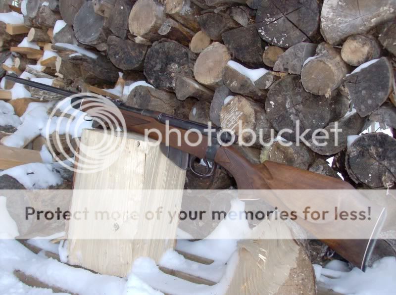

Well this project took a slightly unexpected turn.
I bought a sporterized No1Mk3 recently, with what was described as a "good bore". The charger bridge was all buggered up with poor welding, and the barrel has deep pitting in two places; there's little hope for this one (except a .22 insert for the barrel, repair to the receiver etc; it's in the "maybe one day" pile now).
So, let's see. A MLE sporter action. And really nice sporter wood from a donor No1Mk3. I couldn't resist.
I stripped the butt stock and forend (ugly dripping varnish on it, "redone" at some point in the past), patched the right side of the sporter forend, adjusted the butt plate (it was too large), used a bit of stain on the butt stock to match it to the forend and refinished with oil. It may not be as nice and balanced as a Lee Speed (nothing is, right?) but it'll have to do for now! :)
Special thanks to Tiriaq for his help and advice.
