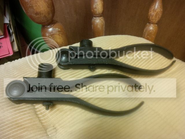

So I've recently waded into reloading, due mostly to finding this in an old box of parts.
So far, it's been great. Slow, but a good pace for a beginner, and a guy with a young family who can't get to the range that often anyway. I'm loading .308. I'd add .303 to the list if I could find dies.
The kit will neck size only. That hasn't been an issue yet, but I'm told after a few runs, the bolt will get hard to close due to the shoulder spacing... And a fl resize will be needed then. Is that accurate?
If so, what are my options for fl resizing without investing in a completely different press?
With the kit, there was a machined .308 fl die, no threads or anything. Just looked like a piece of round stock that was machined down. It looks like it was beat to death. I tried resizing a case in it so I could take some measurements. Used a block of wood in the bench vice to push the lubed case in, but the force required was ridiculous, and about 3/4 of the way in the case just buckled and pancaked. Had to pound the case out with a dowel, and that took some real doing. So I don't know what's up with that die, but it's not a part of the kit, and it's beat to hell anyway. Any advice is appreciated.

The latest version of the "Nutcraker" or 310 handles were made of aluminum. They came in 2 sizes, small and large. Lyman still makes and sells these handles, but the assortment of new dies available are mostly for cowboy calibers, ie 38 Spl and 45-70. Lyman has a decent website.
IMO yours looks like the small size, not for 308 Win, sorry. They sell new for 70 U$D, so an ad in the EE will probably get you enough to buy a decent set of 308 Win dies.
Most, but not all dies for the 310 hand tool were of the neck size only persuasion. All bottle rifle calibers were neck size only. They sold a shell resizer, and that is what your die is. If you look on Flea Bay, search "Ideal Shell Resizer" and they should pop up.
I have one in 308, and like yours it is grossly undersized, takes kilo pounds of force to get a case into it. I used an arbor press.

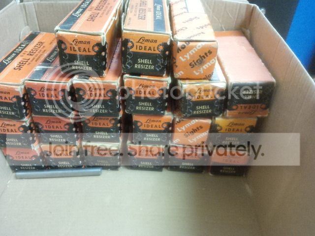

I have a box of them, purchased at a gunshow, while having a temporary lapse of good judgement.
If your handles were the large type, you could probably find a set, I think I have a complete set, but they are pricey if you buy from a collector, much cheaper at gunshows. What you want is a 310 set, 4 to 5 dies, and not the Tru-Line Jr set, 2 dies.

I do indeed have the "large" 310. As well as all the dies needed for reloading .308. I've made a few small batches of ammo already with success, but I'm just concerned about the need to fl resize after ??? uses of the brass. (The one in the photo in the op was just ripped from the interwebz as I didn't have a pic handy when posting. My bad. Should've googlefu'd more carefully. )

As mentioned, Lyman made a full length pound-em sizer, but they're seldom seen nowadays. Lately I'very been regressing to my 310 tools, like I used in the seventies. Some friends say that I have too much time on my hands now that I'm retired. The .308 case is pretty thick and hard to resize with hand tools. If the cases were military or fired in a sloppy chamber, that would worsen the problem. If you have a friend with a press who could full length resized them first, you would be a mile ahead. If you didn't use belch fire loads and watched your case length and hopefully had a nice round chamber, you would be good for lots of shooting.
As an aside, I usually give away my aluminum handles and just use the older steel ones.
