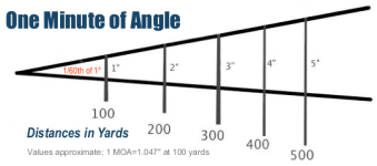

Yes . MOA is a 3 inch circle at 300 yards ?
MoA is minute of angle. It's based off a circle - 360 degrees is a full circle, and each degree can be further divided into 60 minutes. This terminology might be familiar to you in the context of paper maps, where coordinates may be listed in degrees and minutes.
So when you use MoA to talk about the size of a group, it is distance-dependant. At 100yds 1 minute of angle is a linear distance of approx. 1.047". At 300yds 1 minute of angle is 3 times larger, or about 3".
Here is a picture. If you're still not quite sure let me know and I'll try to help you understand.
