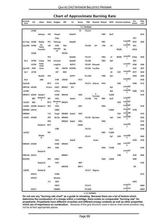

Here is a pretty good powder buring rate chart listing most powders. If a book suggests a powder you don't have, this chart might help you find a similar speed powder you do have.
http://home.hiwaay.net/~stargate/powder/powder.htm

Here is another very useful powder burn rate chart. You can click on this image and then download the larger image file for printing. (You will need to search around the page for the DOWNLOAD IMAGE button)
