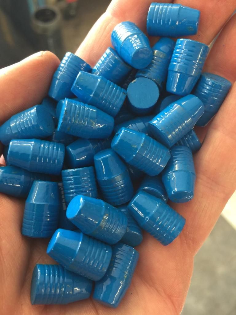

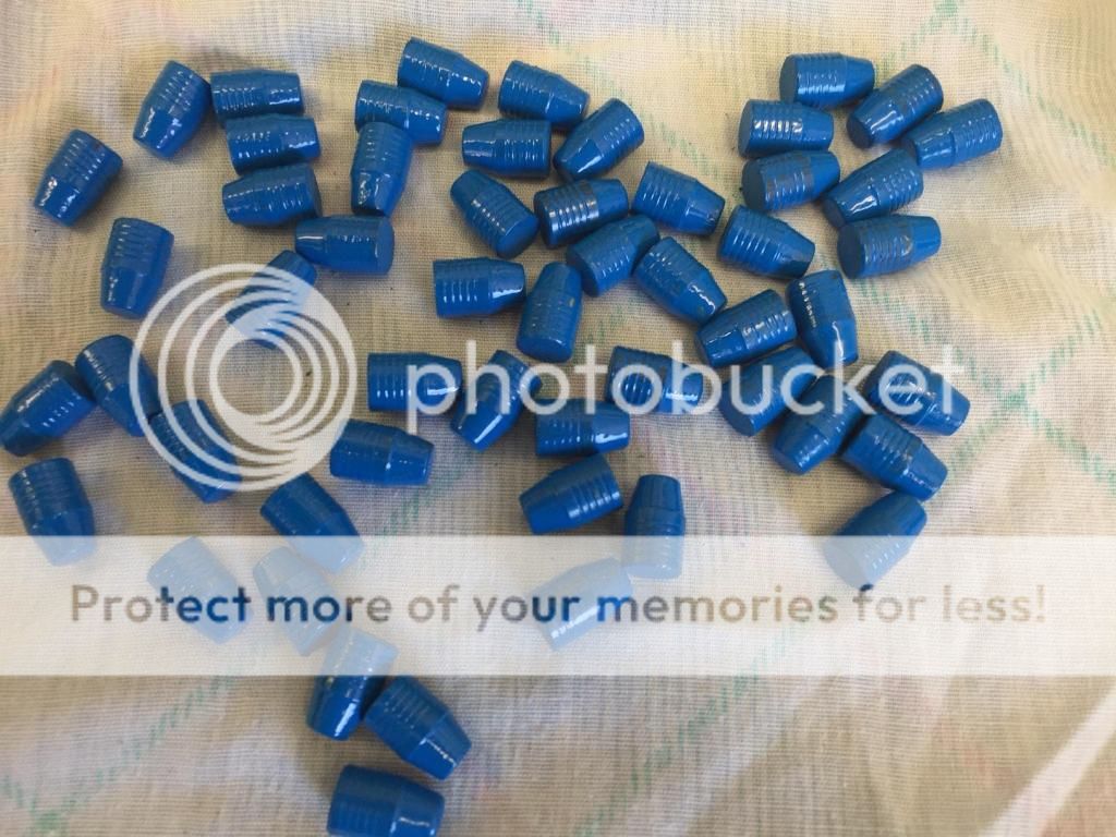

As they come out of the oven and then sized.
Close up: Note that these ARE SIZED! That stuff sticks like crazy and prevents messy lube application. I'm so done with that....
Makes real pretty cartridges!! We do 9mm and .40 S+W. Shoots very well.

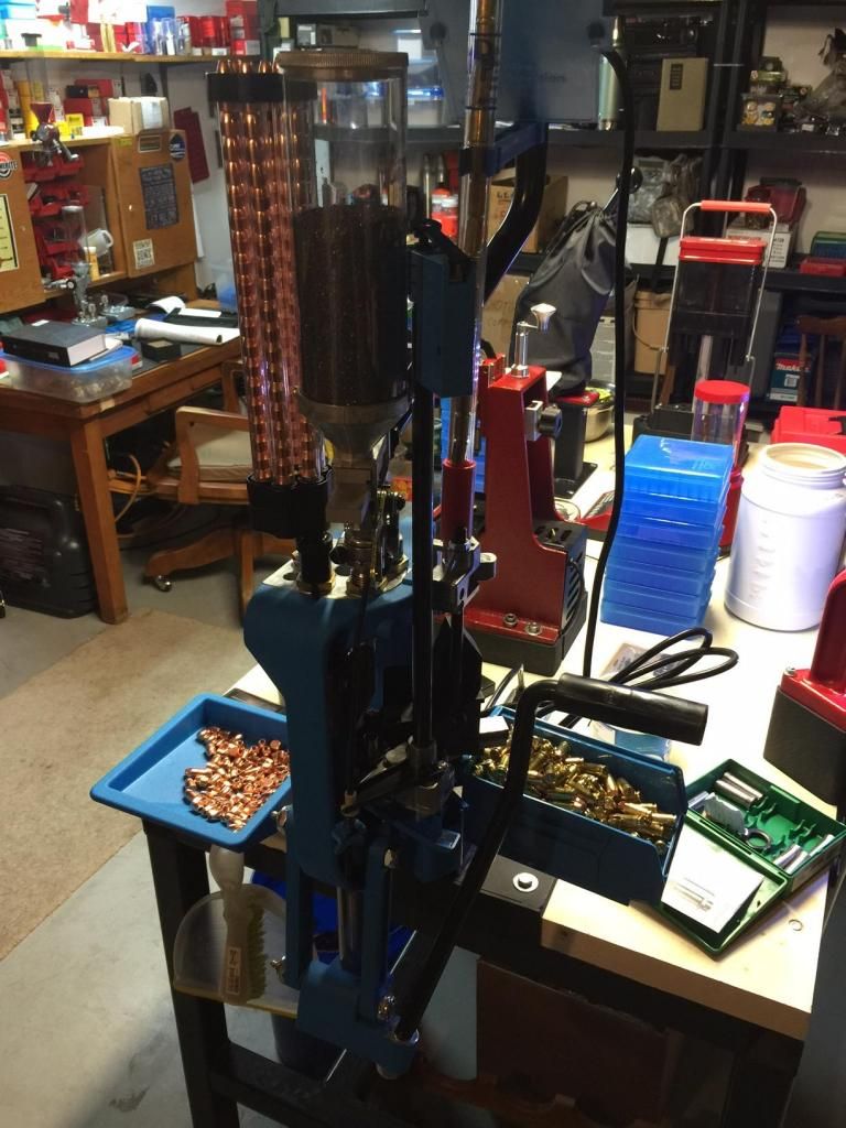

The great thing is they go through my Mini Mr. Bullet Feeder like crazy. Here's a pick of my setup if you havent seen one. While this doesn't have my powder coats in it, you can see how it works there and it feeds through great. No lube gumming things up, around 600 an hour at speed.
