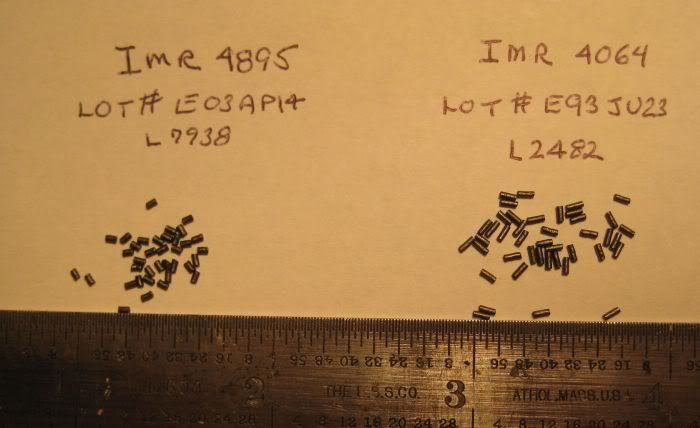

Shake and carry on. The two powders are actually the same powder that has been extruded and cut differently. They are basically interchangeable.

They are not the same powder, H4895 is made in Australia and IMR-4064 is made in Canada and have different burn rates.

When the Expro factory (Canada) made these powders, they started with the same dough and the only difference was how they extruded and cut the powder.

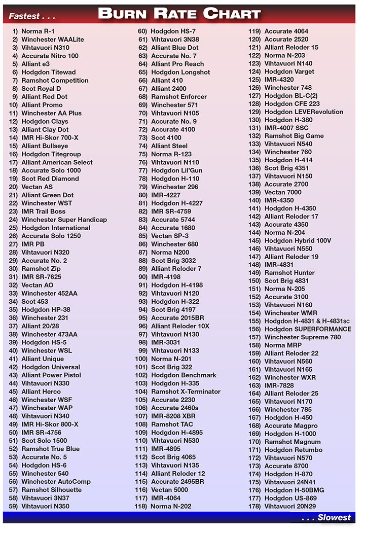

Ganderite, Hodgdons H4895 is faster burning than IMR-4895 and IMR-4064 is slower burning than both. What your saying is it would also be OK to mix H332 and H335 because they are the same and they are not. H4895 is a Australian modified extreme powder and not the same mixture as the older Dupont IMR series powders. And is the size of the powder kernel and its deterrent coatings that control its burn rate.
69. Hodgdon H4895
70. VihtaVuori N530
71. IMR IMR-4895
72. VihtaVuori N135
73. Alliant Reloder 12
74. IMR IMR-4320
75. Accurate Arms 2495BR
76. IMR IMR-4064
The powders are not the same, the IMR-4064 kernels are larger and have more deterrent coatings to make the powder burn slower. And the smaller lighter kernels of H4895 will separate in the powder hopper and end up on top. Bottom line I will never understand why anyone would give out any type of bad advice when there are so many mistakes that can be made mixing powders. And on top of this there are too many new reloaders starting out who could turn this advice into a disaster.

It's not the same powder but it's not gonna make any difference. OP could downcharge or upcharge by 0.64% and probably not see much of a difference outside of benchrest, let alone change that proportion of one powder for another one that's so close on the chart. And even if he loads his ammo to H4895 maximum load and ends up with 100% 4064 powder in his case, he still got less than maximum. So basically, he could have 100% 4064 in his 4895 bottle and all it would do is a weirdly slow round, not a blow-up-in-your-face round, even at maximum charge.

Single base powders vary in speed by deterrent coatings and kernel shape. DNT (not to be confused with its cousin "TNT") is probably the most common deterrent, but there are others, and sometimes more than one is used. The thickness of the coating controls the initial burn rate.
Think of a large kernel of powder like a log. It burns from the outside in. Initially, the large surface is burning, giving off a lot of gas. As the log gets smaller, the surface area is smaller, so less gas is generated.
Now consider the needs of the cartridge. Initially the powder is confined to the case, and the bullet is stuck in the case neck. The last thing you need is the full surface area of all the powder burning at full tilt. hence the deterrent, to slow it down.
Once the bullet starts moving, the volume behind the bullet gets larger, dropping pressure, so ideally you want the powder to start burning faster, to make up for the increased volume. Over the first inch or two, that happens. as the burn speeds up as the deterrent layer is burned off.
Then the bullet is rapidly moving down the barrel, dropping pressure, and the kernel surface is getting smaller, generating less and less gas. This is not good.
A well designed powder is progressive. That is, it burns faster and faster, not slower and slower. Deterrents help, and also the kernels have a hole tough them. Think of a fire log with a 1" hole drilled end to end. The kernel surface burns on the inside, too, and this increases the burning surface as it burns, helping to offset the outside surface getting smaller.
If you start with a vat of powder dough and extrude it in two sizes (larger diameter and length - as in 4895 and 4064) the larger chunk powder will burn slightly slower. This can be modified by changing the deterrent treatments.
