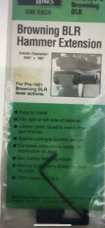

So with a gahzillion phone calls and lost count on emails I decided to see wtf it would take to adapt to fit one.
Chap in Merritt had a BLR 81 Grov-Tec for a few kibble.
Made the trip, found a wealth of ammo (including 410) and this extension.
Looker at it fur a bit.
Tride a file but this was gonna take sum serious reebs.
Then the light bulb came awn.
Four hacker saw blades stacked would fit t'ween the slawts.
No chit, maybe five wuld fit but only arf four.
Tried push'in pull the blades and that gartzs old reel qwick.
Clamped the blades into the vice and pewpzy dew, worky like a charm.
Push'n pull and oh chit, blades cut skin too.
Square file to tidy up the inside corners ehhh voila.............hammer extenshun awn Ole'78.
The blu-print......
Parts I used.
A little bit oh this.
A little bit oh that.
Presto..........finito.............:cool:
