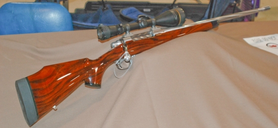

If you REALLY want a challenge in reloading 300 Awesome is the answer. I created this caliber based on 338 Lapua magnum, improved it and necked the casings down to 30 cal. Sends 240 gr bullets down range at 3450 FPS. I suspect something lighter could get close to 4000 FPS
Barrel life is under 1000 rounds. Mine needs 16 MOA to make the 1000 yard mark, these generate 6000 foot pounds of energy, so will kill most game quite easily.
