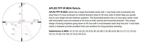

I have an Athlon Argos G2 8-34x56 FFP-MOA-iLL that is great except for the limited Vertical Adjustment - only ca 45 TOTAL MOA. I needed about 20 MOA on a rail to easily zero at 100 and need to reduce to 20x to get 175-yds zero on the reticle. The reticle has 'numbered' MOA every 4-th bar of the tree, which helps in holds for varying distances and wind corrections. Much easier than having to 'count' the bars to adjust holds. The Alpha-numerics are for illustration, NOT actually on the reticle and alternatively there is a MIL reticle available. PS-'Other' Athlon scopes have a better adjustment range but few have the higher mag.

Sounds like it might be worth picking up a canted rail and some Burris adjustable rings if you haven’t already
Right, I got the Burris XTR insert-set and a 30* A419 rail. At present I have it set up with 20* "final" with the Burris adjustment inserts to get the 175. If I ever get a longer range to use I can change to 30* or more.
