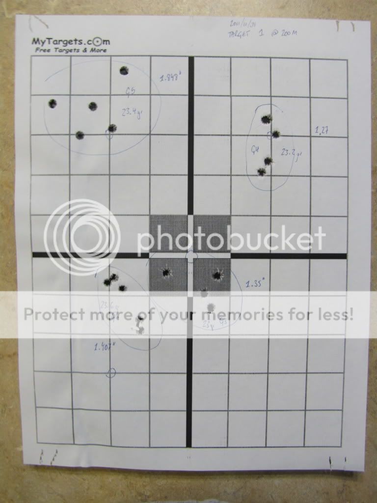

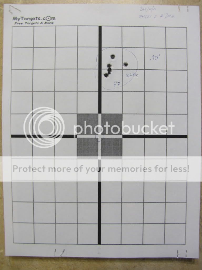

Berger 80gr VLDs
Here are the results of my most recent load development with Berger 80gr VLDs. All were fired from fire-formed Hornady brass, CCI BR-4 primers and Varget powder.
I did some reading online about the 80gr VLDs and it seems that Berger recommends a .04" jump to the lands. My OAL ended up being 2.41". I loaded the following 5 round batches:
- 22.0 gr
- 22.5 gr
- 23.0 gr
- 23.2 gr
- 23.4 gr
- 23.6 gr
- 23.8 gr
- 24.0 gr
- 24.2 gr
- 24.4 gr * I could feel the powder crushing inside the case when I seated the bullets on this load *
Here are the results, shooting on a nice day with little wind at 200 meters, off a pedestal rest.
My apologies for the slight bluriness of some of the pics.

I will have to do some more testing ... the batch of 23.8 and 24.2 are a nice .5 MOA but I was surprised to see that none of the groups had that horizontal or "football" shape to them. I literally weighed each load. I haven't gotten very hard-core about my brass yet, I've measures a good sample and they all have the same length. I took a deburring tool to them but that's about it.
I could be a bit off in my OAL length, I used the cleaning rod method to figure what depth to seat the bullets.

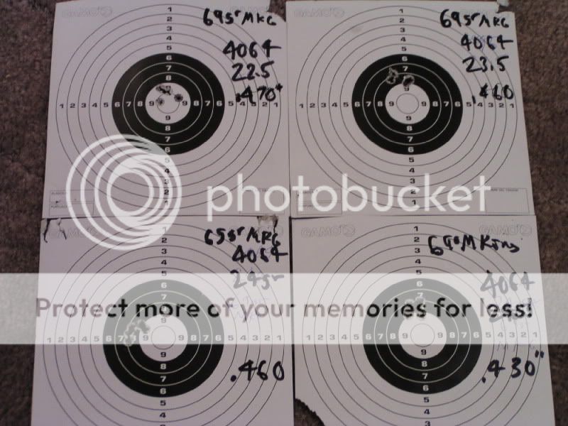

Below are the 100 yard,five shot groups that I fired yesterday morning with my Tikka Tactical in .223. It has a 1 in 8" twist, and I have a 4.5-14x50 scope mounted. I was using the 69gr Matchking, and IMR 4064. It was -3 degrees with a slight breeze, so I didn't bother with a chronograph. I like the fact that the accuracy is quite consistent, all the way from 22.5gr to 24.5gr. Now I need to see how it performs in warmer weather, and how it does at longer distances.
By the way, I had this rifle, and a CZ .223 on the EE, with the intention of selling whichever one sold first. Luckily for me,the first serious buyer wanted the CZ.
So was 2.41" the COAL that gave .040" of jump, and you loaded all your ammo to that length?
At this point there's no real gain to be had from fussing with your brass.
Your ammo seems to shoot "a fat half MOA" across the whole spread of charge weights. It would be nice to tighten this up a bit.
Two suggestions:
1 - were you able to check if your bullets were seated straight (i.e. their T.I.R. Total Indicated Runout is low)?
2 - try some different seating depths. Based on what you've shown, I would load 30 rounds with 23.5 or 24.0 grains of powder; for 10 of them seat the bullet to +.070" jump, for 10 of them seat the bullet to +.010" jump, and for 10 of them seat the bullet to .010" jam.
All ammo was loaded to the same length. Unfortunately I have no way to check runout. Should seating depth be one of the first or last things that I experiment with? As in, is it best to try different powder loads first or to start with a recommended load and play with seating depth?
You have to try both charge and seating depth, but it probably makes most sense to get the charge weight in approximately the right ballpark (as you you done - you have shown that there isn't any sort of wacky-crazy-sensitivity to charge weight, and you have also confirmed that pressures are reasonable/sage), and then fiddle with the seating depth. After you have some seating depth that improves thing, you can then go back and perhaps fine-tun the charge a bit.
If you want to drop by with your loaded ammo when you are heading to the range we could run it through my runout indicator.

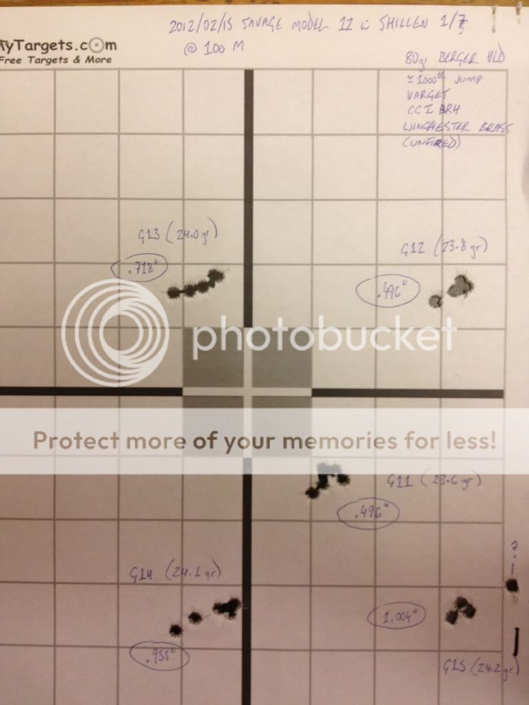

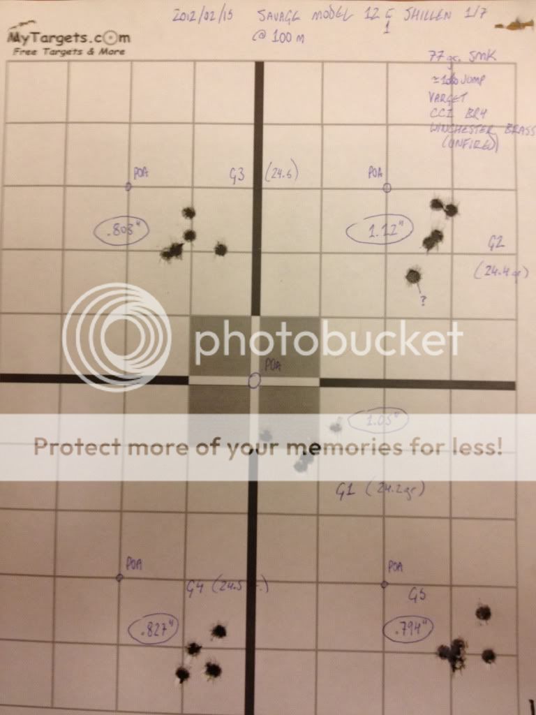

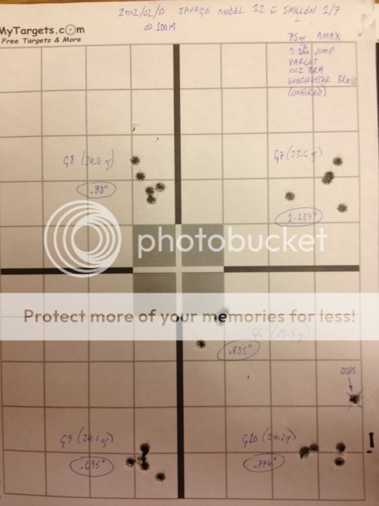

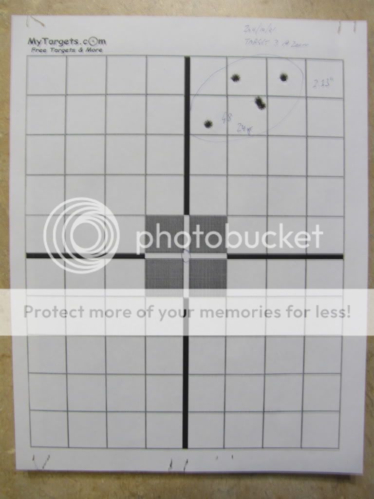

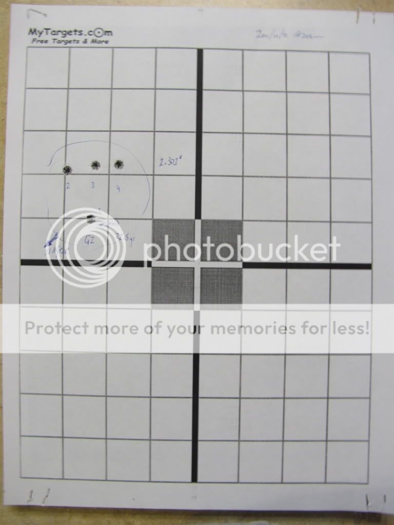

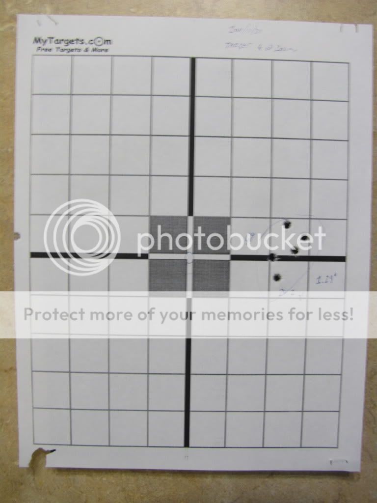

Finally a nice day at the range!!!
Got out to the range today, +5', very little wind, sun ... what more could you ask for in February.
I fired Sierra Match Kings, Hornady AMAX, Berger VLDs. I don't know what was going with the AMAXs, the SMKs weren't as good as I had hoped, but the Bergers show awesome promise. I'm pretty pumped to load some more. Any suggestions on how to improve the groups would be appreciated. I know I need to play with seating depth next time I'm out.
Here are the results:
SMKs
AMAXs
VLDs
